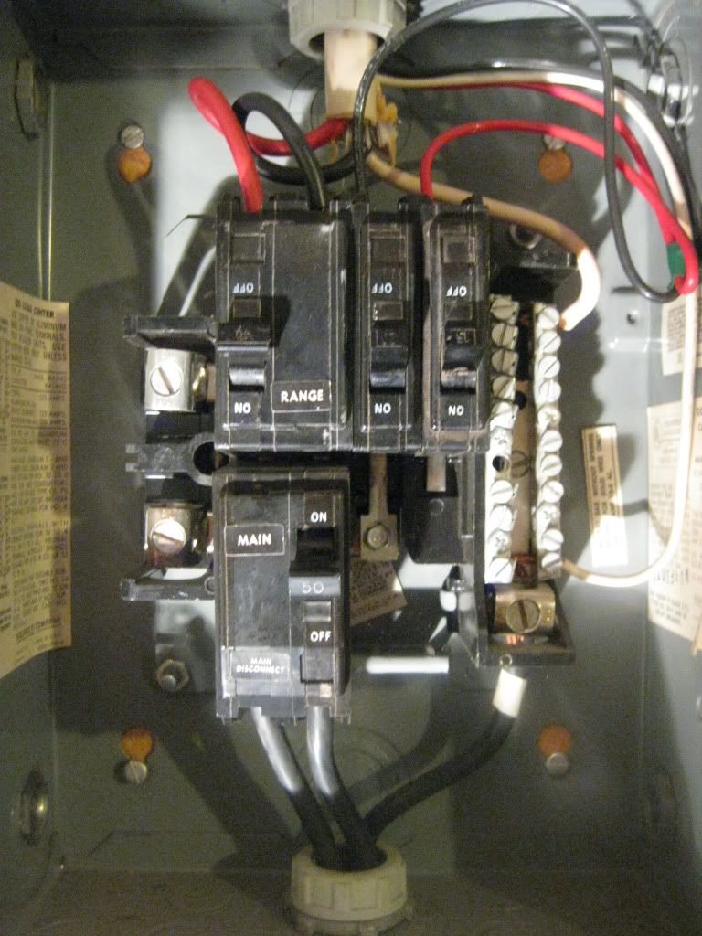

Also, I have attached a photo of my breaker panel. Does each hot leg alternate left to right, or top to bottom?
Last question: If the 20amp and 15amp circuits are both in use, how could the neutral not exceed 20amp? Why wouldn't the neutral amps be additive if the circuits are on opposite phases?
The neutral current cancels out and is the difference of the hot currents when they are on opposite phases (legs). In this case you cannot exceed 20A on the neutral: 20A - 0A = 20A. If both hots were active: 20A - 15A = 5A on the neutral.

Let me clarify a couple of things, then ask a question about the last response.
The house is a duplex. From the main panel, there are two smaller panels. The picture I posted is one on of the two smaller panels. Above the panel and inside a metal enclosure are the grounds that are run with the romex. They are all tied together and bolted to the metal enclosure. The metal enclosure is connected to the panel. The main panel is grounded with #4 to my water service.
1. Am I in need of a ground bus bar inside the panel? If so, what needs to be grounded, and can I install one?
2. What is a "back fed main breaker?" Is that an acceptable situation?
You guys are extremely helpful. Can't thank you enough so far.
