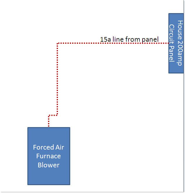

Now, a few more details:
- I do have this generator to power other devices in my home (fridge, fan, lights, etc)
- I do NOT have this connected to any sort of sub panel, transfer panel, etc. I would love to do that eventually.
- I also would like to power my gas, forced air furnace with this generator, so I purchased the Reliance Furnace Transfer Switch (link above)
I did some really crude sketches to show what I'm thinking:
First, the setup today:
- furnace is supplied with power from a 15a line from the main house panel
- there's a receptacle in line that has a single outlet controlled by a switch. this is currently used for a small pump that collects condensation from the A/C in the summer.
- I'm mentioning this b/c this is where I was thinking of "tapping" into the line
Now, for what I'd like to do:
- install the transfer switch near the switch/outlet receptacle
- take the line from the receptacle and use it for the "input" into the transfer switch
- take the line OUT of the transfer switch and back into the receptacle
- power the transfer switch from the Gen with a properly rated extension cord.
I'm am just a simple DYI'er so this is pretty crude. I know I have to go over the instructions again to make sure the switch can be wired this way. I'm using the receptacle box since its a place where the power line is already "cut into", for lack of a better word.
Let me know what you think!
Old 02-01-11, 09:20 AM
Join Date: Mar 2006
Posts: 18,374
Your generator is rated for a continuous output of 5,500 watts with a momentary surge output of 6,000 watts.
Your proposed connection diagram is fine. Connect all the bare (equipment ground) wires together along with any green wires that may be present. Include a green bonding wire to the enclosure if it is metal. Connect all white wires together. You will have only black wires connected to the actual transfer switch. It is not necessary to "ground" the frame of the generator.
Old 02-01-11, 09:35 AM
Join Date: Jul 2005
Location: Pennsylvania
Posts: 440
Hi Furd, thank you for confirming all of this! Wow, I'm very excited. We've really been hit hard with storms last year and this year and I would love to tell the wife we'll be warm if we ever have an extended outage. I will post progress and pics on here when I finish...now that I have the confidence to "start" :-)
