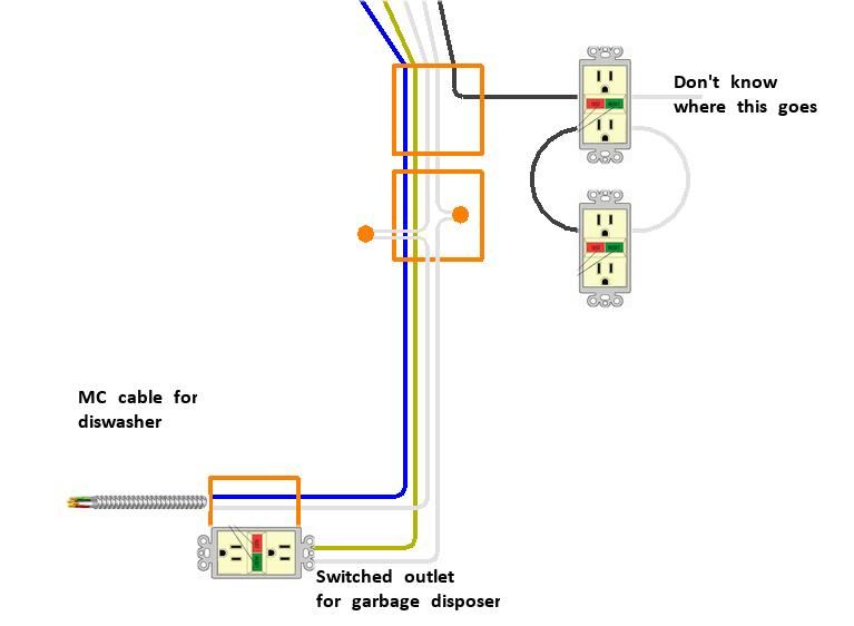

Where should this wire go? I am left with one "orphan" wire.
Last week I asked about a situation where I had two outlets that will not fit inside a two device box because of the depth of the outlets and the amount of wires inside the box. The thread I started is here:
http://forum.doityourself.com/electr...evice-box.html
This was the original two device box.

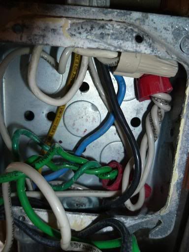

OK, so the way I solved it is to use two two device boxes, one on top of the other. Because of this I had to take apart all the wires and I carefully wrapped each wire with different color tapes so I know which goes with which. Well, for some reason, one white wire (neutral) does not have the tape on it anymore. This could be due to me pulling the wire in and out of the conduits several times and it fell off.
So this is the new configuration.
You can see from the top, we have five wires coming into the box. A blue wire, a yellow wire, a black wire, and two white wires.
The blue wire and yellow wire pass straight through the box and goes down below. The blue wire (hot) eventually connects to an outlet which is for the garbage disposer, it is switched. The yellow wire (hot) goes to a three wire MC cable for the dish washer.
The black wire goes to the GFCI outlet for the top box. The two white wires also run through below to be the neutral for the disposer and the dishwasher. One white wire connects with wire nut label 1, another with wire nut label 2.
If you look at my GFCI outlet, the top has a black wire (no problem) and a white wire which is the one with the label missing. Where should it go? The bottom black and white wires are not a problem I just need to hook it to another outlet which will go into the box below, I know the green wires are not yet mounted, I will later.
Right now I don't know where the white wire of the outlet goes to.
Help!

I am thinking, it should go into the wire nut where the other white wire goes to the unswitched disposer cable?

I see you have done a lot of work to get everything to fit into the box, but I do not think you have enough space between the boxes to allow the trimplates to fit.
How many total circuits are we dealing with?

I would certainly try to fit the trimplates before you drywall. It will be easier to switch to a short pipe nipple now instead of later.
OK, you say you have three circuits. Follow the two neutrals back from the disposal and dishwasher. The one left over will be for the receptacles.

Not only that, Jim, the boxes he used won't accommodate the installation of the receptacles without a plaster ring. Those are junction boxes, and not receptacle boxes.

I said three circuits. I know the disposer switched outlet is dedicated. I know the dishwasher is dedicated. I am not sure about the outlets, it could be coming from another junction box. What I know is I have five wires coming into that conduit, three hot and two neutral.
A schematic is below. The "gray" colored wires are actually white, but I can't draw white on white so I made it a bit gray and may be hard to see.
So may be you are saying I should have six wires coming in, three hot and three neutral?

The "standard" way would have six wires (3 hot, 3 neutral), but there are possible configurations that would legitimately have 3 hot and 2 neutral. The gist of it is that two hots would share one of the neutrals, but it can be a little tricky to determine which one is the right one to share.
Do these wires come right from the panel or go through some other location first?
