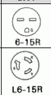

If you continue to plug in the pump instead of hard wire be sure the pump receptacle is a 6-15r or a L6-15r.

thanks ray..the plug is rated for 220 (it said that on the pack) the prongs that carry current are both slotted horizontal and the plug and the receptical came as a set.
It is not just the voltage rating but the amp rating also that is important.
You should have one of thse configurations:
