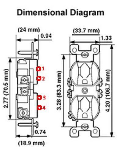

I bought some new Leviton duplex receptacles.
It has two brass screws on one side and two silver screws on the other side. I know the hot goes with the brass screw and the neutral the silver screw. But on the back, it has four holes (for backwiring) on each side. So for the hot, does it matter which of the 4 holes I use as long as it is the ones on the same side of the brass screws?
Also, is there any significance to line up the wires going to which screw? I see some of the existing wiring done previously, had the hot going into hole #1 on the brass screw side, and the neutral going into hole #3 on the silver screw side. Does it matter? or not?

It doesn't matter.

It doesn't matter, but if those are backstab holes, I wouldn't recommend using them. What do the directions say? Just strip and push/stab the wires in or insert wires and tighten screws? Backwiring receptacles is good, but back stabbing is not so good. What is Leviton catalog number on the devices?

The receptacles I am using is Leviton BR15-SW. The product description says "Leviton BR15-SW 15-Amp, 125 Volt, Narrow Body Duplex Receptacle, Straight Blade, Commercial Grade, Self Grounding, Internal Clamps, White". I bought 40 of those and wanted to change out all my outlets except for the GFCI ones.
BR15-SW > Standard Face > Duplex > Straight Blade Receptacles - Commercial Specification Grade > Straight Blade Receptacles > All Products from Leviton Electrical and Electronic Products
You can insert the wire to the back and tighten the screws.
Since there are 4 holes on each side, and consensus is that it does not matter, I am just curious why there are that many holes. I understand for GFCI there is a LINE connection and a LOAD connection, but this is not.
So, if I want to wire a series of outlets, I can connect the HOT to brass "1", connect another black wire to "2", and connect the other end of that to the next outlet's "1", and so on. This would work?
Lastly, the fact this outlet is "self grounding" then it means I don't need to tie a green wire from the green screw to the back of the metal box?

yes, you can wire as you state with a "feed" in one hole and wire going downstream to next receptacle in another hole. this is how I wired all of mine. some do not like this way, the main reason being that a loose screw on a receptacle could cause you to lose power not only to that receptacle, but to all downstream receptacles. for that reason some prefer to use "pigtails" for the black and white. I felt comfortable doing it the way you mention since I was backwiring (the kind that have screws) , but would not do that for backstabbing (the push in connectors-which are only for #14 AWG anyway)
as far as I know you still have to connect ground to the green screw. the "self grounding" probably refers to a piece of metal that holds one of the mounting screws tight and assures a good contact between the screw and the receptacle body. if you screw this into a properly grounded metal box, then the receptacle is grounded. I think you can only use this method of grounding if this is surface mounted box (like you often find in unfinished basement or crawlspaces or garages). I don't think you can use this if flush mounted box (like the boxes in your main living areas) and obviously you can't use it with plastic boxes.
