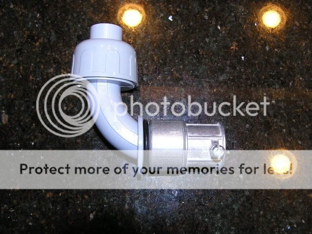

Oooo I hate those connectors No, that is not it.
Here is the fitting we call a tomic coupling:
Note: we have used these all the time in sizes ranging from 1/2" to 1 1/4" and no inspector has ever said that it is an improper fitting.
Here is an assembled set of fittings using a 3/4" EMT set screw connector (You will need a compression) the 3/4" tomic coupling and a 3/4" LFNC 90 degree connector.
I have an extra coupling I can sell you for $20

Sold your advice alone is worth it, lol. I hate those connectors too... I have seen so many of those improperly torqued b/c they are so flimsy going in everyone feels the need to make sure they're tight.... That tomic coupling looks just like a rigid coupling! How long is the tomic coupling overall? (between the o-ring and set screw conn.) thanks

That is why I called a rigid coupling but they are not as long. It is only about 3/4" long. (1/2" are the same length.) They are rigid threads as all connectors, locknuts, bushings, etc. are rigid threads. When the fittings are screwed in on each side they meet in the middle.
Again, make sure you pull in a ground if your using non-metallic flex.
