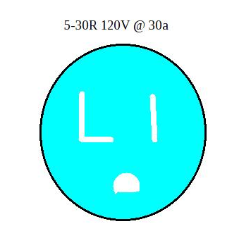

I have an old air compressor that is required to be plugged into a 30 amp circuit. I'm thinking of using 10/2 cable, or 10 gauge wire for it, I have the 30 amp, single pole breaker, but can't seem to find a 30 amp outlet at the local hardware store, plenty of 15 and 20 amp outlets, just can't find a 30 amp, I asked about it and they looked at me like I was goofy. Are there 30 amp duplex outlets availiable ? Is this the way this should be done ? Thank you !
Old 05-01-11, 06:17 AM
ray2047's Avatar
Join Date: Mar 2006
Posts: 33,597
Received 13 Votes on 11 Posts
No. You need a simplex receptacle NEMA type 5-30R. If you don't have a 5-30P plug on your compressor you should change it out.

The end of the original cord is just a regular 2 prong, with a ground, 3 prong if you look at it counting all prongs, ground included, the kind you would find on any regular household appliance. It's 110 volt, no I'm not reading it wrong, that's exactly what it say's on the original sticker ! It also say's on the same sticker that it requires a 30 amp fuse or breaker. It works fine when I plug it into a string of outlets I ran with 12/2 cable and 20 amp outlet recepticles, nothing gets hot at all, So, should I change the wire from the motor and put a plug on it like you sent me the picture of, or what ?

Ok, how would I go about wiring the motor for 240
The wiring diagram should be on the name plate.
would I need to change the plug to what "ray2047" suggested below,
No. My suggestion was if the motor was run on 120v. You would need a 240v plug and receptacle. Since the 240v FLA is 8.9 you may be acle to use a 15 amp breaker and a NEMA 6-15 receptacle plug but going with a NEMA 6-20 as suggested by Justin gives more breathing room for starting.
