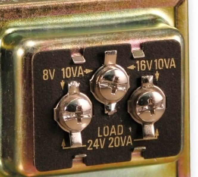

The left screw says 8V 10VA. The right screw says 16V 10VA. The middle screw says 24V 20VA.
I moved the black chime wire to the right transformer screw but it made no difference. Then I switched places between the button and chime wires and still it didn't work.

I'm guessing that this is the transformer the OP has. I could not find any instructions, but bet they came with the transformer, or are printed on the box

Here's the transformer

Good. The arrows indicate center and right give the correct voltage. Use those two and my last diagram modified to use center and right not left.
See how the two arrows at 16 volts point to the correct screws.
