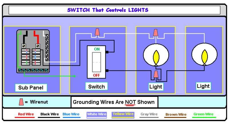

I came back to complete it last week and hooked up some pot lights (4) to the switch I set up last year (everything is on 14-2 wire) and found that when I turned the lights off, the breaker flicked off too. It should have been a simple parallel circuit but it is not.

My apologies. It's a breaker switch on a 100Amp service.
Coming in are 2 lines, one from the main breaker box and one continuing on to the receptacle line servicing the room. There are only 5 receptacles connected to the line and one dimmer switch (which works).
I joined the 2 black wires coming into the box together with a short black wireto feed to the switch, and similarily the whites and neutrals. I screwed the short black with the out going black wire to the pots, and similarily to with the whites (and neutrals). Then I joined all the pot blacks together, the whites together and the neutrals together as I had read in another forum.
The breaker trips everytime I turn it off.
Does this help visualize the issue?

Are you saying you have a white wire connected to the switch? If so, remove it.
The only wires on the switch should be the power in and the switched feed going out to the lights and a grounding conductor.

Switches only need to break the hot leg in the circuit. Neutrals are unswitched and splice thru a switch or fixture.
A white connected to a switch is not a neutral. It would be part of a switch loop. It should have been re-identified as a hot, but often times was not.

Cool Switch Problem on New Circuit
Hello misha karo
You might already have your lights and switch hooked up and working.
But if not here is a fast drawing I made on how to wire up your project..
Hope this helps ---
Let us know how you made out with your wiring project
Have A Nice Day
Linesman

This is exactly what i was looking for the last 24 hours. I will be doing the lights tonight and this makes it clear as blue sky. Thanks so much for making the effort and all of you that basically supported linesman in words. Tell you how it goes.

Works like a charm guys. Many thanks. Once I get the finishes done, I'll go back and put on a dimmer.
