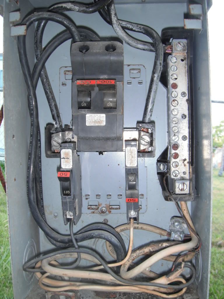

We are trying to troubleshoot my son's trailer house electrical supply. He has a main box in the yard that has a pair of main breakers & 2 smaller single breakers that each say 50 on them. They both have very small gauge wires running from them, far less than what looks like would carry 50 amps. One of those small breakers was off. I can get 110 from either main to neutral & 220 across the pair. When I turned the one 50 breaker that was off I couldn't read anything on that side. As soon as I turned it off I could read 110 again. Can anyone provide feedback on why this is set up this way & what might be going on?

Okay, it looks like the main feeders (always live) come from the top of the main panel. Then there's a 100A breaker to the subpanel, which is backfed into the 100A breaker. So far, so good.
You are likely correct, that looks like 12ga wire, which has no place being on a 50A breaker. Do you know where it goes? Air conditioner maybe?
I have no idea how turning on the one breaker would give you 0v to ground/neutral without causing a direct short and either a tripped breaker or fireworks. Maybe I'm missing something... but it certainly doesn't make sense. Can you figure out where those wires go? It's odd that it goes into the same conduit as the feeders to the subpanel.
As for the different size breakers, they are called "tandem" breakers. You can install them on panels that accept them to get you more breaker spaces. As long as the panel is designed to accept them (the model number of the breaker will be something like xxxx16/24 meaning it can accept 16 full-size breakers or 24 using some half-size or tandem breakers).

Is the first picture on the pole and second in the trailer.
There are multiple problems the 50a breakers are wrong because of size and they apear to be uses as a 240v breaker but you can't use two single pole as a double pole except maybe handel tied and they aren't.

That GE breaker doesn't belong in the Siemens panel.
There shouldn't be a wire bonding the neutral and ground buss.
The feed should go into the 100A breaker, and the trailer should be the buss lugs.
The 50A breakers should be no higher than 20.
Fpe panel needs to be replaced, due to high failure rates.

There looks to be some splices not shown. Look at the large white neutral in the service panel. Now look at the color when it gets to the interior panel.
TF, is this service panel fed from the top or bottom?

OK.... 1st, Thank ALL of you for your great input, that's what makes this (all of the DIY forums!) so awesome...
I went back & took a much closer look & made some determinations. To answer some of the questions, the power comes in from the top & goes to the two side lugs. The feeders coming out of the breakers on top go to the sub panel inside the trailer. Those two individual 50's on the bottom fed the AIR CONDITIONER. They were in 220 service, not ganged & whoever stated that the wire looked about 10, well it was probably 12... WAY undersized. That unit burned up several years ago, no doubt from sucking low volts all that time. I killed the other one & will probably remove those.
The jumper wire from the ground buss to the neutral buss was removed. It's arced slightly so there was a small amount of potential leaking through there. The wires coming in to the sub panel are all black & two that leave the main panel (ground & neut) were white so there has to be a splice some where. I didn't crawl under the trailer to see where the conduit ran.
The two ganged 30's in the sub panel fed the heater air handler motor & a 220V outlet for a dryer in the utility room. Some testing determined that the dryer outlet was on the Siemens breaker & the HVAC blower on the GE breaker. A gas dryer is in service so the 220V outlet is not needed so we swapped the wiring for the HVAC blower to the Siemens breaker & just disconnected the wiring from the GE breaker & turned it off.
Now for the kicker.... While checking all of the various circuits I noticed that one buss seemed to be quite a bit hotter than the other one. Further checking showed that some of the breakers had a low output while the ones on the other bus were a bit hotter. Measuring across the 220's showed a good 220 but individually one was hot & one weak. I went all the way back out to the main post & checked the feeders coming into the main breaker. There's an OBVIOUS difference in potential on the feeders coming in. This makes me think there is a problem with the transformer or maybe an open neutral, allowing the voltage to float across both busses..... We are going to call the power company & have them trouble shoot it from their end.
I took some more pictures & added them to the Photobucket album, including 2 shots of my voltage test on each buss. You'll see what I'm talking about. So HOPEFULLY this is a problem on the power company side that they can address & get this right!
I am surprised to see it, but I see you have access to the unmetered power in the pedestal. Normally the power company seals these parts of the equipment and the customer cannot access. In pictures 6, 7 and 8 I also see the underground lateral connections in the unmetered section of the pedestal that look pretty crummy, water has been getting in there. I agree, call the POCO. I am thinking they will find their problem right there in the pedestal in those corroded connections

Well, the POCO came out on father's day (sucks to be on call but....) & determined that the neutral supply conductor was bad. They strung a new temp neutral above ground with plans to come back this week & bury it properly. Anyway, my son says that everything is working perfectly in the house now, & at no cost to us! I haven't been down to look at it since they came out but I expect they will properly seal the back side of the pedestal.
