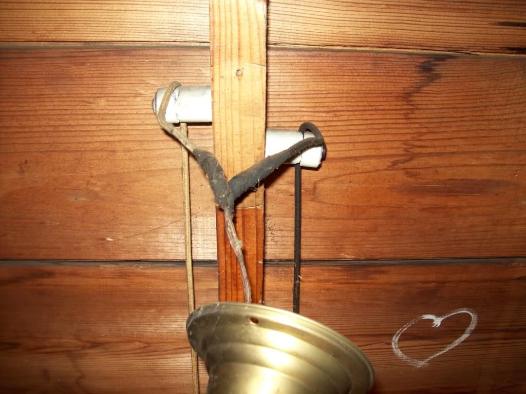

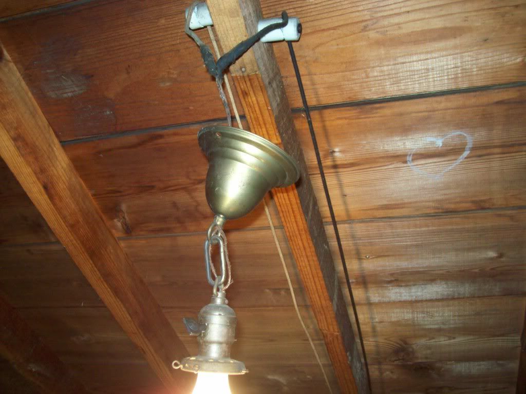

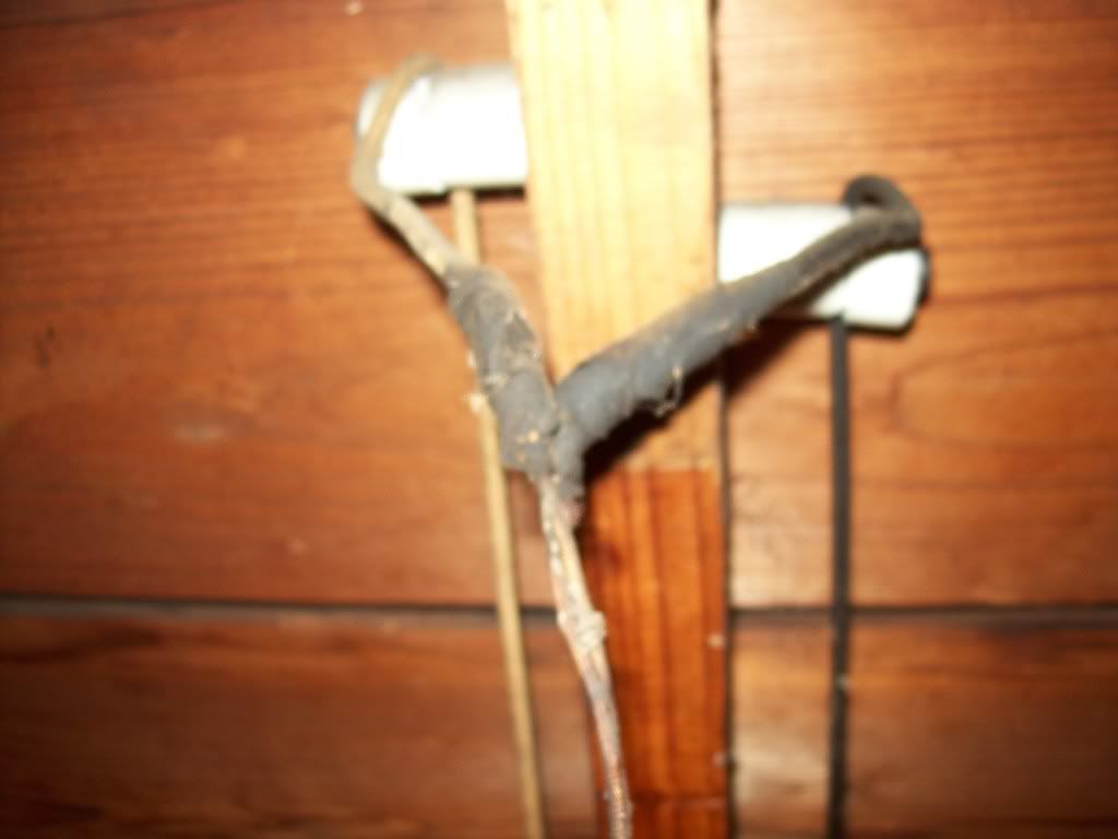

Hey, I'm installing an attic fan and first need to install a junction box in my attic. I have A light up there but no junction box. My house is really old, built around the 40's I think. I know a little about electrical but from what I understand I need to attach the junction box to the joist. and do I either make "pigtails" to the main wires from the light and fan, or just connect them into a wire nut? Here are pictures of how it currently looks:

What you have there is an accident waiting to happen. It is NOT code compliant in any way, shape or form and never was. That lamp fixture is being held by ONLY the electrical wiring and THAT is simply wrong.
You have what is known as "knob and tube" wiring. Current electrical code does NOT allow any extensions on such circuits. Your only code compliant means to power the attic fan will be a new circuit run from a source that is not on a k&t circuit. Most likely that means a new circuit from the fuse or circuit breaker panel.

You could use a different circuit as long as it is a grounded circuit and it does not serve one of the special circuits like the kitchen, bath, laundry or a dedicated appliance. However, once you've run the new cable to the basement you might as well do it correctly and go to the breaker panel.
The light fixture is dangerous as-is because there is no box to contain the wiring -- it is right up against the framing. A spark could ignite the wood. The old knob and tube wiring is also beyond obsolete. It should be left as-is undisturbed or gutted and replaced with a modern wiring method. It is particularly dangerous on that sloped ceiling because your hand could easily touch one of the poorly insulated wires and get shocked.

As was already mentioned, what you have cannot be extended.
In older wiring, the canopy of the light was commonly, although I dont think it was legally, used for the splices, however what I usually see in such installs is a pony cleat lampholder used, not a decorative fixture. Your best bet is to replace it with newer romex wire, with a fluorescent fixture or a porcelain lampholder.

Just to throw in another warning, the age of your wiring may indicate that the insulation on the wires may be brittle and moving them around could cause it to flake off, resulting in more issues.
Most K&T wiring is best left untouched until it's ready for replacement.

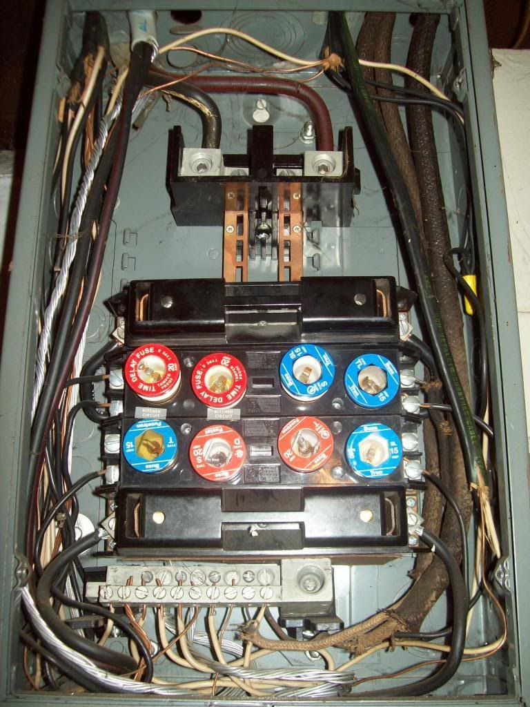

Ok I'm not planning on touching any of the k&t wiring now, and I went to check the junction box in my basement and it has newer wires running to the circuit breaker but also k&t wiring attached in the junction box... could I add to that if its not a dedicated circuit? and I don't think I have the option of going straight to the circuit breaker...

That is a fuse box in your picture. There seems to be an unused 15 amp fuse on the lower left. You could run a 14-2 NM-b cable from that. If there is no open space for the neutral and ground you may have to double up a couple of ground wires. The neutral can't be doubled.
You also seem to have an unused 20a but I'd save that for future use where you need a 20a circuit.

When you run the new circut, be sure to use some sort of a listed bushing. I don't see any used there.

Unless I miss my guess, that's an old Federal Pacific split bus fuse panel. The top pullout should be the lighting main.

I was also looking at the attachment method of the fuse blocks and the design of the panel can edges where the cover/door attach. FPE made fuse panels similar to this for many years after the Stab Lok breaker was introduced and widely used. Their fuse panels were popular because of the versatility they offered in selecting what amperage fuse blocks you needed for each job. I still can't say for sure that it's an FPE, but sure looks like one to me.

Yes, I am curious. Look at the front of the panel, inside the door and inside the box for any labels that might be there to indicate the manufacturer. Also look closely at the fuse blocks and see what the labels say on them between the center two plug fuses.

It looks a lot like an FPE split-bus panel I replaced a bit ago. There are 2 or 3 spaces up top for 240v fuses, then a likely 60A cartridge fuse module that connects the remaining 3 spaces (currently used by 8 small circuits and one 240v larger circuit).
While there's nothing inherently unsafe about fuses and fuse panels, if you plan on continuing to do electrical upgrades, I'd certainly add a replacement breaker panel to your to-do list. If nothing else, it'll give you more spaces and a chance to clean it up!
