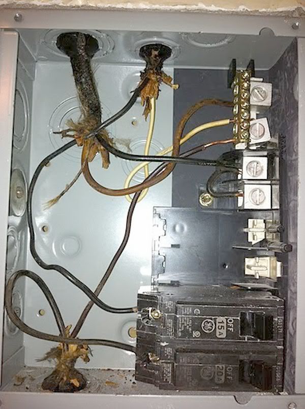

I don't think that ''brown'' wire was brown when it was installed.

Thank you for the extra pictures.
It is obvious that your neighbor (the one with the double-pole circuit breaker) has a dual voltage service as opposed to your single voltage service. Even though he still has only a 30 ampere main circuit breaker he has double the amount of POWER.
You would need to have the cable from your apartment panel to the main circuit breaker (in the electrical equipment room) replaced with a three-wire (plus equipment ground) cable of no less than #10 size. How difficult this would be depends upon how it is routed. You do not have conduit so that alone makes it much more difficult. You would also need to have the SERVICE CONDUCTORS between the kilowatt meter and the main circuit breaker replaced, adding the required third wire (second "hot" wire) and also improve the equipment grounding. The panel in the apartment would need to be reconnected to take advantage of the new "feeder" cable and dual voltage supply. After that you really need additional circuits installed in the apartment.
Definitely not a DIY job and definitely will require permitting along with utility involvement.
A combination of age and temperature will cause this color change. Since it is a simple 120 volt circuit you can look at the black wire to see if there has been insulation degradation from being overloaded and too hot. I don't see any damage to the black wire so it follows that the discoloration of the white (to brown) is not caused by excessive heat.

And the jumper between the two hot legs of the sub may not be legal because of double lugging. When you adjust the gamma you can see the wire is "old" white not brown. I don't see the red at the sub. I wonder if it was cut off. Not good but is that 20a breaker over amped.

Looking at adjusted pictures it seems the red may be the third wire for a 120/240 and the conduit may provide a ground. Still got my fingers crossed for Niesian the cable to the apartment is 10-3 with the red cut off.
The double lugging with the jumper is definitely a code violation, but it wouldn't be necessary if the single pole breakers were installed in the proper positions (1 & 3 rather than 3 & 4). All the double lugging does is heat up two additional spaces which obviously is not necessary since there are only two circuits in the apartment.

Further, those main lugs are too large for the #12 or #10 conductors installed. The minimum wire size for those lugs is probably #4 but possibly #6. A back-fed "main" breaker (with proper hold-down) could have been installed in one slot and then the proper size jumper installed between the main lugs.
Bottom line, it is just a lousy installation all around.

Makes you wonder what a Jersey AHJ would say. Just depends on how much your willing to PO the landlord. Certainly though you do a need an opinion from a licensed electrician that does not work for the landlord. The landlord's EC who you were considering calling may be responsible for this mess in the first place.
