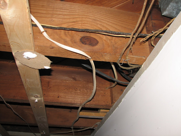

I want to re-wire my house. It was built in 1940, and the electrical is currently a hodgepodge of romex, antique cloth insulated wiring, and from what I can tell there's probably some bubble gum in there...

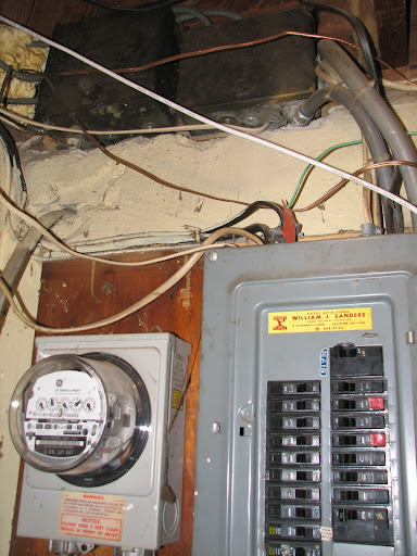

This is my current panel layout:
Isn't it pretty?
I have some experience with wiring and am comfortable running lines and hooking up outlets, but nothing on this scope, and I also am aware that to upgrade the panel (which I think is sorely needed) to 200A which means a new main line to the house, so obviously I need a proper inspection and such, so a pro is a must.

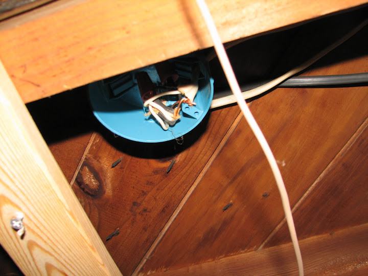

BTW if you liked that pic, here are some other gems:
Morrets? What are those???
Seriously, why do we need to cover the copper?
Nobody will EVER put a nail or screw in the CEILING...

We do get trips from time to time. Between the fridge, dishwasher, disposal, 3 computers, 2 laptops, my power tools and my a/v equipment, I just don't think a 100A box is enough and did you notice those two little offshoot boxes in the pic?
They scare the hell out of me, frankly.

I just don't think a 100A box is enough and did you notice those two little offshoot boxes in the pic?...They scare the hell out of me, frankly.
Those are probably the original fuse panels from 1940. When someone upgraded to the breaker panel they either fed the old panels as subpanels or used them as junction boxes to extend the original circuits to the new panel.

Those two black boxes are just junction boxes. I have seen a number of them installed in my area in older homes.
