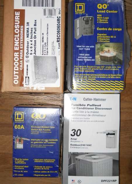

Here are the boxes I bought yesterday. I'm inclined to use the "Outdoor Enclosure" Wiegmann box as it's basic and generic. But, there is nothing inside it to attach a receptacle and terminal strip.
Thanks for any ideas you could share. Maybe I'm looking at the wrong type of exterior boxes and there are some that have attachment places inside.

All of those boxes are for hard-wired connections. To actually install a receptacle inside the box you would need to mount a small handy box inside the bigger box. I think what would meet your need would be one similar to the upper left box pictured but larger, probably like an 8x8 or 8x12 NEMA 3R. This would be considered an "access panel" in my opinion and not a junction box due to the issues with using the flexible cord. The code doesn't have a great way to deal with exterior plug-in pumps like yours, and I think the solution you have is as good as any.
You might want to check for a small outdoor subpanel on sale at the big boxes. You can gut out the subpanel parts and just use it as a spacious 3R enclosure.

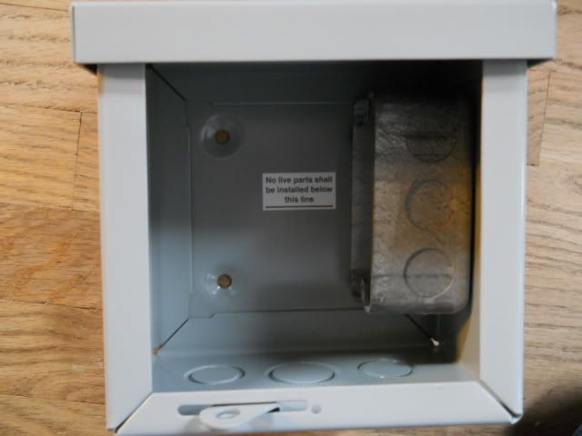

Thanks for the suggestions ibpooks. Is this what you had in-mind?
You're right that I'll need a larger box as there will only be 4" in-front of the plug with this 6x6 box. Would I just screw the handy box into the junction box's back panel in whatever way I choose?
Could I just buy some terminal strips (like a small neutral bus bar) and screw them in anywhere too (for the two alarm wires)?
I'll look at prices of panel boxes but I'll bet using a junction box like this will be a lot cheaper. I'm hoping to keep the box as small as possible too.
Thanks.

The problem I see with the box as pictured is that it would be very hard if not impossible to wire the GFI. Also how would the cords enter the box?

If you buy a cheap 2-space breaker panel, you can gut it and mount the handy box on top facing down and still have plenty of bending radius. Just be sure to use a bushing where the cable exits the box.
