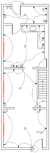

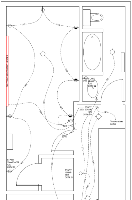

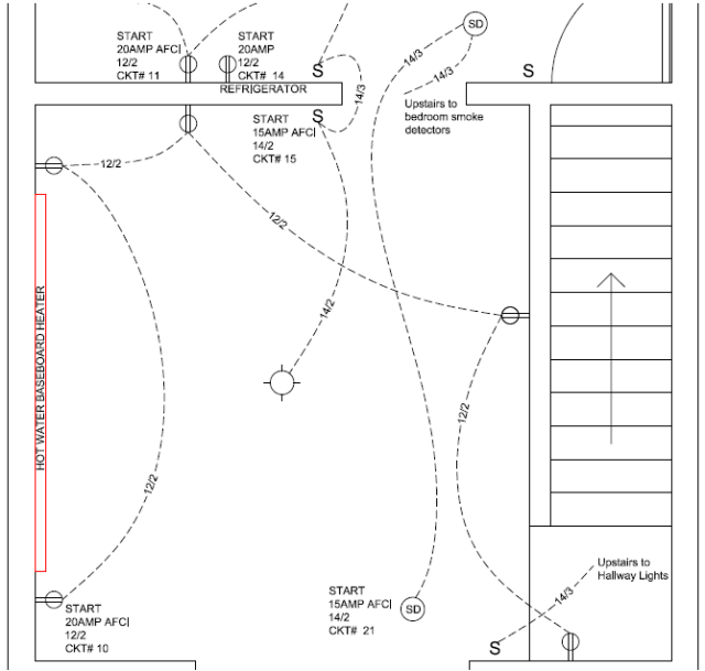

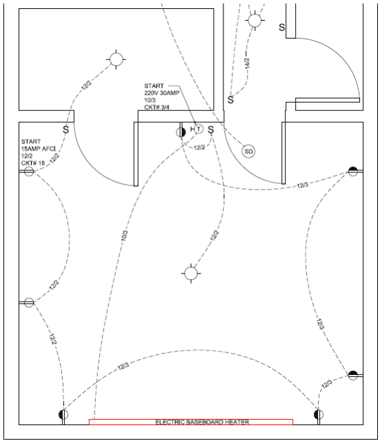

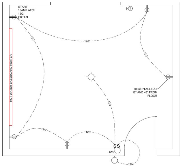

The layouts as promised
Laundry Room (1st Floor)
Kitchen (1st Floor)
Dining Room (1st Floor)
Living Room (1st Floor)
2nd Bedroom, Bathroom and Hallway (2nd Floor)
Master Bedroom (2nd Floor)
This is the complete 1st Floor. (old wiring plan, don't follow)
  #24

There are a number of good quality copper bus loadcenters on the market and I agree with a lot of the other's recommendations. The Square D QO and Cutler Hammer CH series are both lifetime warranted along with their respective breakers, no other manufacturer makes that claim (ultra premium panels and you pay for it).
Siemens and Cutler Hammer BR series makes both aluminum and copper bus and I wouldn't be afriad to go with either brand with the copper bus (I am a bit partial to Siemens). I think they both warrant these breakers for 10 years.
Considering the number of AFCI breakers you will be needing, you'll have a real mess in your new panel. I just saw a catalog cut this week on a brand new Cutler Hammer CH series panel you may be interested in, it has the new plug on neutral bus and is supposed to eliminate that tangle of neutral pigtail wires from the AFCI breakers. I am assuming there may be a new AFCI breaker made just for this new panel, I'll have to check on that. The catalog cut I saw also had a 200 amp main breaker and a whopping 100 circuits! I haven't found much through Google, I think it's too new but I did find a new plug on neutral AFCI breaker (no pigtail neutral wires!).
CH115CAFPN - 1P 15A 120/240V COMBO ARC FAULT PLUG-ON NEUTRAL - Eaton Cutler-Hammer - Thermal Magnetic; 1 Pole; 120/240 Vac; 15 Ampere; Interrupting Rating 10000 Ampere; Box Lug Terminal; Wire Size (2) 14 to 10 Awg (Aluminum/Copper), (1) 14 to 8 Awg (
I found just a 42 circuit plug on neutral loadcenter.
Western Extralite Company - CH CH42BPN200K PLUG IN NEUTRAL LOAD CENTER WITH 200A MAIN BREAKER

I don't think you have enough lighting in the kitchen, but that would depend on the style you install. Have you considered undercabinet lighting?
I would not install a smoke alarm in the kitchen. By building codes you need one per floor, one per bedroom and one outside the sleepingt areas. You might need a CO detector also.
BTW, in the US the voltages are 120 and 240.

I was thinking of more lightubg for the kitchen, mainly around the countertop/cabinets, I just don't know what to go with.

The kitchen countertops will be heavily shadowed in your current plan. Add some undercabinet fluorescents and/or some recessed cans appx every 4' above work surfaces. Make sure to add a light directly above the sink or have the sink centered under two lights. You also might want a separately switched overhead light in the lower left area of the kitchen if you intend to put a small breakfast table there.
As for overhead lighting it depends a lot on what kind of fixtures and light you want (incandescent, track, fluorescent, etc). It's always better to put too much light in a kitchen and then reduce it down with smaller bulbs or dimmers than to not have enough. My best suggestion is just to go to a lighting store and see what appeals to you. There are all sorts of undercabinet lights.
Same issue in the 2nd floor bathroom. The narrow area with the toilet to one end and the vanity to the other will be shadowed. You may want to add more lighting in that area and consider a separately switched direct light source over the vanity mirror like a strip light so you can see to shave, do your hair, whatever.
Just a note that you will be limited in the type of fixture you can install in the master bedroom closet depending on how the rods or shelves are installed. Code has clearance requirements to prevent lighting cloths on fire. The safest option is an enclosed fluorescent.
You may want to locate a light over the 2nd floor landing at the top of the stairs.
Any provision for dishwasher or garbage disposal?

Thanks for the suggestions on lighting, I will look into them and possibly stop off at lowes or homedepot this weekend to see what I can get. I'm going to have as hard of a time deciding what lighting to get as I am deciding on a color to paint the walls.
No dishwaser or garbage disposal plans at the moment.

I suggest pulling the circuit and putting the receptacle under the sink just in case. Beats making the mess twice.

The upstairs hallway receptacle looks like it shouldn't be getting power from the switched overhead light. It looks like you'll run into trouble with that if you run it as drawn.
Some other less critical ideas:
- You don't need a 20A dedicated circuit for the washer. It can run off the 20A laundry circuit you already have there (since it runs about 5A). Of course, how you have it drawn is fine too.
- Where's your stove/oven? Don't you need an exhaust hood? I'm a big fan of microwave/hoods for smaller kitchens. It's a great space savings (but requires a dedicated 20A circuit)
- I'd personally install one of those magic light switches (door jamb mounted push button switch) in the master closet. Makes it easy to turn the light on and off!
- I'd consider installing fan boxes and 14/3 wire to each of the bedroom lights. Even if you don't want a fan today, you can then easily install one down the road. (not sure where in the US you are though)
Looks good though! Good luck!

The receptacle in the hallway is not switched, its just on the same circuit.
The stove/oven is a gas stand alone unit that was going to go after the counter on the right, but I have since changed my plans and am putting the sink on the counter to the right and using a slide in gas range/oven in the back counter, about in the middle.
I actually had a question about this, what circuit can I use to supply power to the gas range? Can I use one of the countertop circuits or the kitchen (non-countertop) receptacle circuit or do I need to add a dedicated circuit.

The NEC now requires any location that could later be used for a ceiling fan to have a fan rated box installed regardless.
Does that mean no more plastic nail-on ceiling boxes in bedrooms, dining rooms, kitchens or family rooms? It sounds as if this is another case of the code cycle panel getting involved in the design element again and not just safety.

That's right Joe. I've heard different interpretations about whether this applies to off-center ceiling boxes too or just the main one you might expect someone to hang a fan on.
