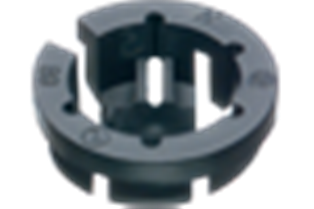

I have a wall mounted GE main panel. That is mounted in the plaster wall. It has plenty of space but there is no access to the outside of the panel. I can open a knockout and fish a wire down but I have no way to put a clamp in. Is there a special type of acceptable clamp for this type of situation? Having only access to the inside.

As for the "clamp" if you can fish the cable through the appropriately sized hole, then, likewise an appropriately sized snap in cable "keeper" will be fine. Their main purpose is not to be so much a strain relief, but to keep the cable from chafing on the sharp edges of the hole in the box. Sample below. Again, check for the correct size for the cabling you are using.
No grounding rod, unless some local building code requirement calls for it.
OK, bad focus, but the original pix was as small as a pin head.
