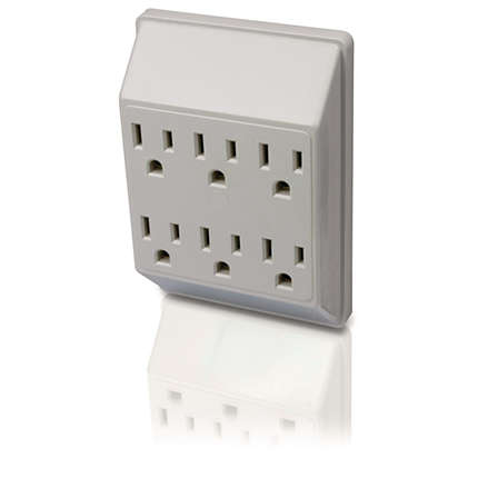

You have a GFCI receptacle somewhere that you haven't yet discovered. I had the exact same wiring scheme in my house built in 1987 and the GFCI was located in the garage. What made it difficult to find was that a previous owner had put a multiple outlet adapter over the GFCI so that it was not obvious that it WAS a GFCI.
(image courtesyof usa.phillips.com)
In your case the GFCI receptacle could be almost anywhere and hidden behind a pile of boxes or whatever.
