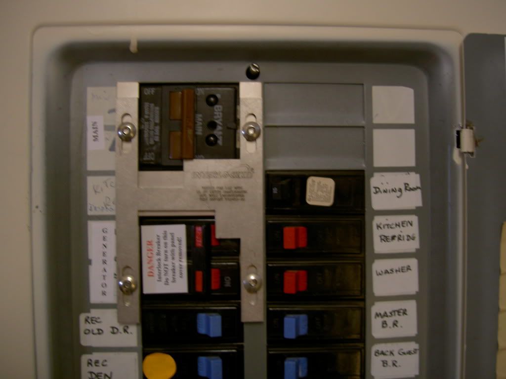

I was trying to determine what type of box I have to see if I could use a interlock kit to connect a portable generator instead of a transfer switch. I noticed one of the breakers was labled "generator" and it is connected to the same breaker as the washer/dryer switch. In essence there are 2 switches but you have to pull them both at the same time(see picture). However, I also noticed an outlet coming out of the box. I assume this would be where I could plug my generator into to power all the outlets in my house.(I realize that I could only turn on a few switches at time based on generator size) I would just need to make sure that main breaker is turned off so that I don't backfeed the lines correct?
However, I'm not sure if this is legal but it looks like this outlet was professionally installed although it was probably done in the 80's so it may no longer meet code.
Is there anyway to use this outlet for my generator and then just select the switches I want. Isn't the only thing an interlock switch does is just ensure the main breaker and the generator breaker aren't on at the same time? Can I not do that manually?
Also does anyone have any idea what model box I have? Part of the descritpion is missing.
See post #3 for picture.

Hi,
You cant use a interlock. You panal will not work.
Generator InterLock Kit - Bryant Kits
You cant backfeed with that plug thats there. As far as I know its not code.
You need to install a new set up like this.

Welcome to the forums. You must use an inlet. You do not have an inlet. You can not connect a generator with what you have.

In order to utilize the receptacle circled in red as a backfeed to the panel you would need to use a SUICIDE CORD. This is both illegal and potentially DEADLY.

A custom made interlock would not be UL approved or pass any inspection. An electrician did not wire that outlet...it's not even close to a professional job and even pretty bad for a novice homeowner.
I don't think you can buy suicide cords...you can buy the parts and make them, but you can't buy one pre-made.
As to running the whole house...in most cases a standard portable gennie won't be able to do that anyway. It's for essentials like a few lights, furnace/ac, fridge, freezer, well pump if needed, etc. The only way to run a house is with a very big portable that can cost quite a bit or a permanently installed standby gennie.

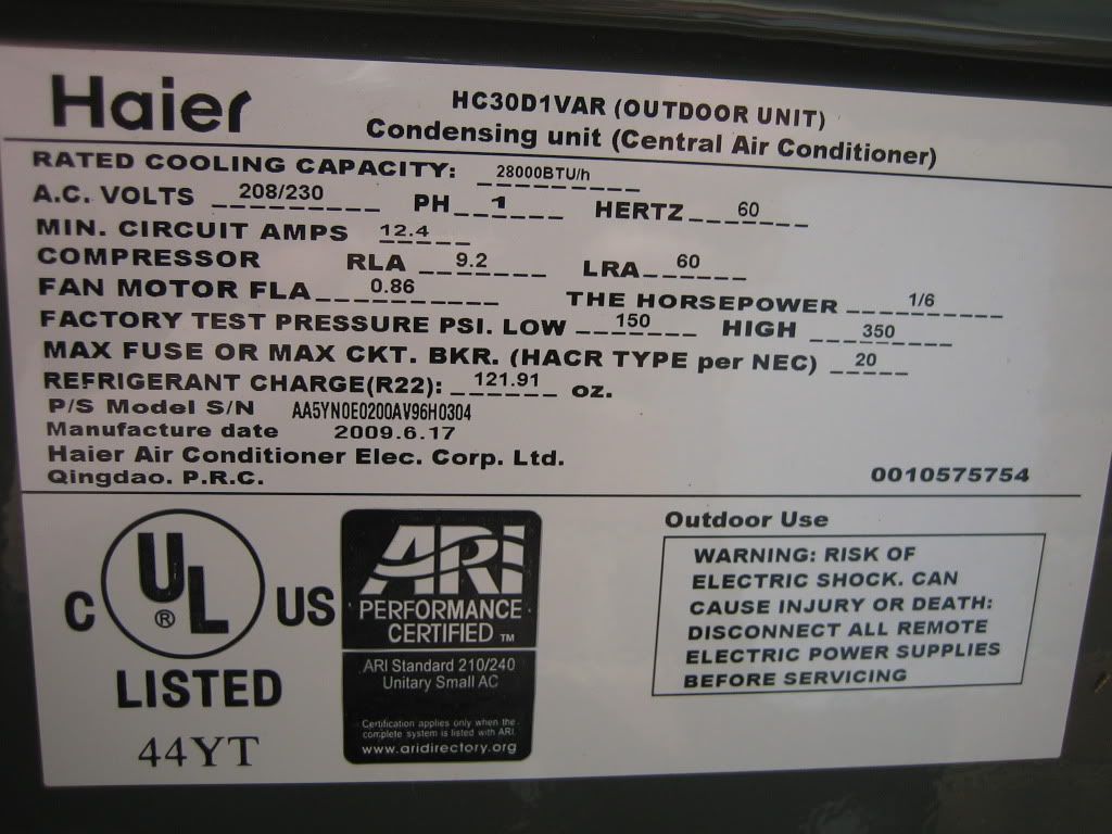

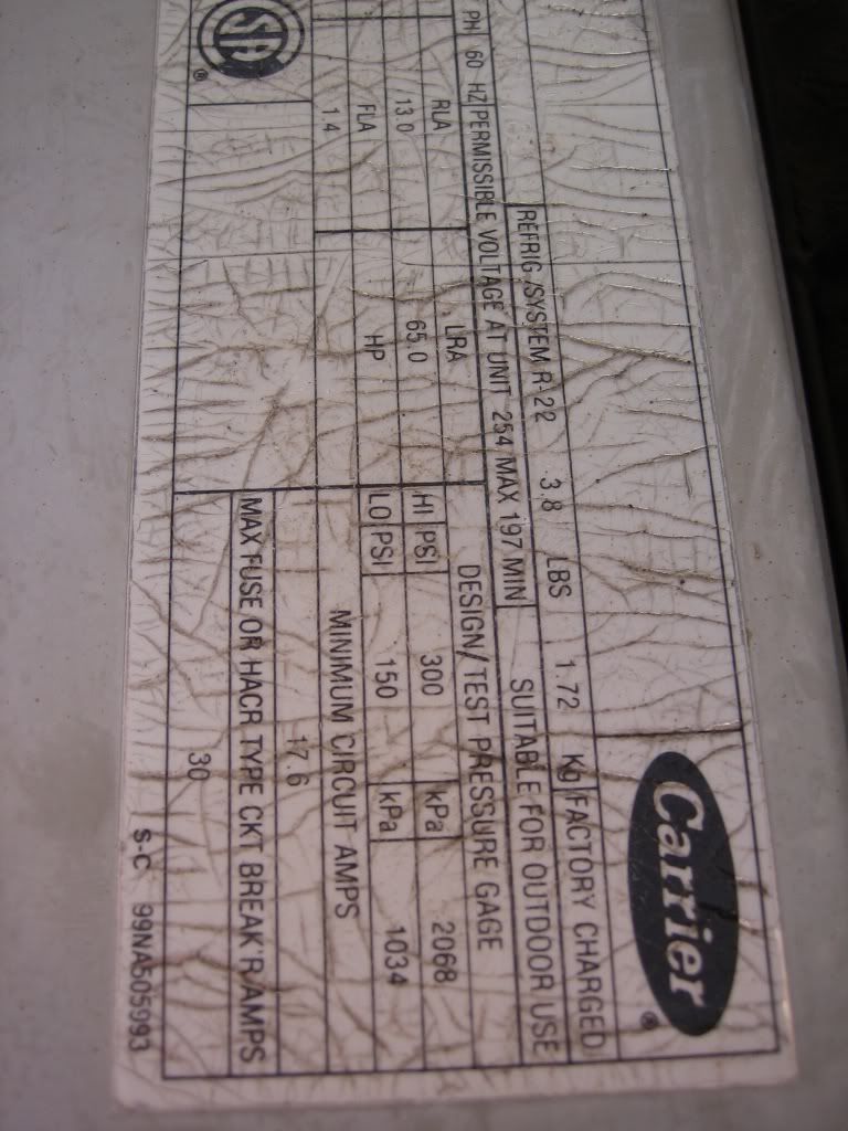

Originally Posted by rtpatter View Post
The smaller AC has a 17.9 amp rating that would be the biggest drain. No other applainces would running when the AC is on. I have been told that a 8000kw generator would be able to power the unit if no other appliances are on.
That would be really iffy. At my own house I have an AC unit with a 12A rating and my 6kW generator will not start it. I wouldn't recommend anything lower than 10kW for your air conditioner and probably more realistic in the 12kW+ range. The generator engine and alternator of smaller units simply do not have enough rotational inertia (mass) to start a compressor motor.
So are you saying that there is no way to power the AC with a portable?
You would just need a big portable or a smaller A/C. A/C units are difficult motors to start, even on line power. The lights dim when you have 200A (48kW) coming into the service.
On the AC label, you can see the LRA = 65A. That is locked rotor amps, or the amount of current the motor pulls when it is at a dead stop. 65A * 240V = 15.6kW. The generator needs to be able to handle that surge or the motor will not start and the generator will stall until breakers trip.

Would it make any difference that I have hard start kits installed on the AC units. I get no lights dimming when they kick on now. Can an electrician easily tell by testing the unit to see how much it actually draws before I purchase my generator? Most of the transfer switches I have seen say rated for 7500w, so I'm not sure how much extra the cost would be to get one that would handle an 8 or 10k?
Old 10-05-11, 01:18 PM
Join Date: Feb 2005
Posts: 10,296
The hard start kits will certainly help. Unfortunately there is no easy test to see exactly which size generator will work, although using a fast response clamp on amp meter will get you a good idea of what the AC unit actually draws at startup. Then you need to account for the fact that the voltage will drop more significantly on the generator so current will be higher than what was measured on line power. It is mostly an educated guess, with enough margin to account for unplanned variables.

I think you are misunderstanding what a suicide cord is maybe. Suicide cords have plugs on both ends, not like an extension cord or a generator cord where you have a plug and a receptacle. With a suicide cord plugged into a running gennie..there is voltage on the exposed prongs.
When using an interlock you use an inlet to connect to the panel (as shown in a prior post)...not an outlet like you currently have.
Main power ok, interlock keeps the gennie breaker in panel in off position, so no voltage on prongs of inlet.
Main power off, main breaker is opened by interlock and gennie breaker is closed to connect inlet to panel. Still safe since no power to panel.
Plug in gennie...all still safe since no exposed prongs and main breaker is open to prevent backfeeding to PoCo.

I believe you will need to change those breakers to 50 amp.
But I dont know if you can plug in or not. It would seem you need a transfer panal or something since they dont seem to make a inlet more then 12,500 watts.

What would be the cost and feasibility of having someone move the breakers in my current box to line up properly with this model interlock...
Assuming no surprises under the box cover:
Appx 2-3 hours labor, about $100 for the 50A inlet and box, $20 in breakers, the interlock kit itself, $50-75 misc wire and supplies, permit & inspection fees, 10 foot generator cord w/ ends about $150. Depending on how the guy bills you might have a trip charge or markup on parts also.

I agree that if I have to run 15kw portable then I might as well get a whole house system since the cost difference would be neglible. However, I'm not sure I need one that size just run one AC unit at a time if nothing else is on. The biggest draw is the 17.9 amp 2 ton unit. To start I figure double that so 36 amps which it should actually be less since it has a hard start on it. So i'm thinking an 8500kw might just squeak by.
Can I not just have an electrician come out and test the unit to get a pretty good indication of what it draws and base my decision on that.
As far as my reasoning, I really am trying to do what economically make sense. My house is not laid out so as that a window unit would fit or really do much good. I figure that if I'm going to spend $600 or $700 to get a generator just to run the fridge and few lights why not spend some extra and get one that at least has the possibilty of running the A/C and the gas furnance it I need it during winter. I know I have seen an individual running his central air thru an 8k portable. I'm not sure what the specifics of his setup was but he was doing it. I realize that my setup is different but I this is really the cheapest way I can figure to run the A/C and the other outlets in the house as needed. I guess I just need someone to actually test the unit to see what it normally draws and factor in a little extra to see what the furnace fan would draw and go from there.
Otherwise, I don't really see the point in powering the breaker box. I should just go buy a smaller generator hook up a cord to the fridge and one light and be done with it.
I like this pricing much more than that of a transfer switch install where they quoted me $700 to $1000

My estimate could very well end up in that range depending on local labor rate and permit & inspection fee.

Just a reminder...I'm sure you already know, but...
Portable (hah...maybe we should say semi-portable for that size) gennies require maintenance. They need to be started and run (or do an end of season shutdown) and taken care of much more than a lawn mower or car.
Oil is important as is good fresh gas .

That is my fear is that I go to the trouble of hooking up to the breaker box and then the thing won't start when I need it and it will be too big to easily transport somewhere to be repaired

It's not bad as long as you bolt some big wheels on the generator chassis if it doesn't have them already and it's no different than moving around a wheelbarrow. The engine should run pretty good as long as you don't let the gas varnish up in the carb. A gas preservative like Stabil helps a lot. It's also a good idea to roll the generator out monthly or at least a couple times a year and run it for 15 minutes. I keep a 5 gal gas can for the generator and every month or two I dump it in my truck and refill it to keep it fresh.
