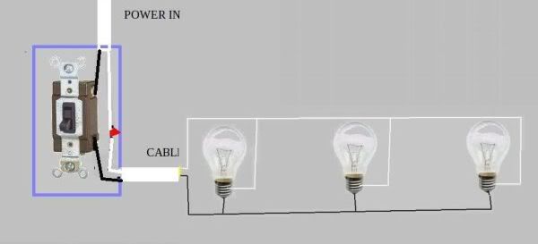

Question I wired 4 lights to one switch and its not working
I recently bought 2 track lights and 2 pendant lights. Im replacing 4 flourescent 2 tube lights with the track light and pendants i bought. I read a bunch of forums on here and followed it for directions. My lights still arent working. Here is how i have them.
Coming from the breaker (15 amp) with a 14/2 cable straight to the first light which is a track light. There i have 14/3 which im running to the other lights. so the first light im connected as follows.
First light Pendant: Black 14/2 to black14/3, white14/2 to white14/3 and white from light, Red 14/3 to black light wire.
Second light Pendant: black14/3 to black14/3, white14/3 to white14/3 to white light, red to black light
Third light Track: black14/3 to black14/3, white14/3 to white 14/3 to white light, red to black light
Fourth light pendant: black14/3 to black14/2 going to switch, white14/3 to white light (stops there), red14/3 to white 14/2 to switch.
Im really not sure were im going wrong. I followed a diagram step for step, or so i think. When i flip the breaker to turn them on and test the switch im getting 120v, but when i flip the switch on it keeps tripping the breaker??
Any suggestions will be greatly appreciated.

Why are you using 14-3? Power should come from switch to first light by 14-2 then 14-2 to then second light and so forth. You shouldn't need 14-3. In your first post you said 14-2 only.
Old 10-22-11, 09:05 AM
Join Date: Apr 2007
Location: Near Buffalo, NY
Posts: 4,239
In your first posts you said the 14/2 from the panel goes to the switch. In post #4 above you said it runs from the panel to the light (more common).
It sounds to me as if you have wired the switch cable incorrectly to the first light. If there is only one 14/2 in the switch box you have to treat it's white wire as if it is black at the other end.
If there was no switch involved, all of the black wires would be tied together, and all of the white wires would be tied together. Like a railroad track, each light is then connected down the line as if they were railroad ties to their corresponding colors.
The switch gets inserted on the black rail only: The black switch wire connects to the black wire that comes from the panel, and the white switch wire connects to the black wire that continues to the first light.
Get rid of the 14/3 or abandon the red wire by capping it by itself at each box with a wire nut.

so at the fourth light: the black light,black from 3rd fixture,black from switch,and white from switch get nutted together? and the white from light,white from 3rd fixture get nutted together and stops there??
Old 10-22-11, 10:13 AM
ray2047's Avatar
Join Date: Mar 2006
Posts: 32,671
well i have the black and white hooked to my switch
That is wrong. As I said in my first post to you the whites are wire nutted together and only the blacks are connected to the switch.
No. At the last fixture black NM-b goes to black of the light and white of the NM-b goes to the white of the light. The switch cable goes to the first light as you originally wired it. Your original wiring was correct except you had the white on the switch.

Panel---Black (hot)----------- Switch----------Light---Light---Light---Light
Panel---White (neutral)------------------------Light---Light---Light---Light
Old 10-22-11, 12:05 PM
ray2047's Avatar
Join Date: Mar 2006
Posts: 32,671
Dryanimtt, I think one thing that is confusing you is that as with many electrical circuits there is more then one way to wire it. How you wire it depends on multiple factors and even given the same factors two different people may wire it a different way. Yet both ways will be correct and both will work.
The way I have shown you I believe is simplest especially if you wire to 2011 code.

ok so i rewired it the way you said and its still tripping the breaker.
What else could be the prob? i got the 14/2 from breaker to the switch were black is connected to switch and black going up to light connected to switch, white is connected to white going up to the first light. at the first light i got black switch,black jumper, and black from light connected. second i have black black black, white white white. same for third and fourth.
Old 10-22-11, 02:03 PM
ray2047's Avatar
Join Date: Mar 2006
Posts: 32,671
Start at the first light and disconnect the cable to the other lights. Test. If ok reconnect the second light and at the second light disconnect the third light and test again. Continue testing till all have been tested.
In other words test with just the first light connected. If ok add the second and test then the third and the fourth.
