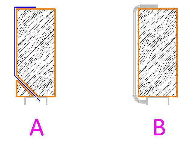

After thinking it through, I am concerned about drilling three vertical holes through this beam. I would prefer to avoid any vertical holes which would weaken the beam. Also I question whether I can really drill 16" from standing on a ladder upside down and not wobble or wander.
I am now thinking the following options, A and B as depicted in my sketch below.
A - to drill a 1/2" hole at an angle from the center of the beam below to the side. Then I will pass a NM-b wire through this hole to the mounted electrical box. I would have to find a way to conceal about 2/3 of the side. May be a strip of wood on the side or something.
B - to use EMT pipe to run on the back side of the beam, totally exposed and paint the pipe to make it look like oil rubbed bronze. Not too excited about this look.
C - is to follow ibpooks's advice to run it along the bottom and build a false bottom, but that's thirty feet long.

, In my opinion, you're working youself up over the wrong problem.
Trust your engineer. Here's why:
That laminated beam consists of some number (4? 5?) of narrower laminates that have been glued under pressure with grain running in opposite directions. Even if the hole you drill completely spans one of the laminates (1/2" probably won't), the surrounding portions will carry the load.
There are maximum hole sizes that can be drilled in engineered products such as this beam. You can confirm the advice you were given by looking up the specs on the manufacturer's website.
I favor Tolyn's suggestion as the one that minimizes disturbing the appearance of the room, and if it were my project, whether for myself or a customer, that is exactly how I would do it. But, of your two illustrations, B is less obnoxious.

IF you do not want to drill the beam (and I don't blame you) running a single piece of 700 wiremold down the bottom, centered in the middle of the beam, might not look as bad as you think. It can also be painted. 3 x 10' pieces will cost you only about $30-40.
You see it in churches all the time.
