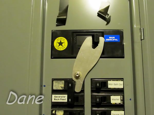

A neighbor in Costa Rica lives off the grid and uses solar, hydro and backs up with a gasoline generator. He basically has monster sized blocking diodes or a device that allows the current to flow in only one direction so he can operate the solar, hydro and generator at the same time. Inside the house there are separate DC and AC circuits. DC is supplied from the batteries. The AC circuit has a transfer switch so it can either come from the inverter or generator.
I have made a simple interlock device for someone (outside the USA's I'll sue you culture) that works quite well. It is a funky shaped piece of 1/8" thick aluminum mounted to the face of the electrical panel. When the main breaker is on this lever prevents the first breaker (which is used to feed power into the panel from a generator) in the stack from being on. I'll look to see if I have a picture.
I'm actually a bit surprised I was able to find the photo so quickly.
As you can see the top left breaker back feeds the panel from the generator. To switch to generator the main breaker must be switched to off which moves the blocking arm out of the way to allow the generator breaker to be flipped on. If you try to turn the main breaker on it automatically pushes the generator breaker to the off position. The size and shape of the lever creates a generous dead space where neither breaker is in the on position to insure that both breaker can never be on at the same time.
The pivot is a simple bolt with a nylock nut and several flat washers to allow it to pivot with a bit of resistance. I remember making cardboard cut outs to work out the shape of the lever and sticking a small nail through to find a pivot point that worked.

Understand that Pilot Dane's "solution" is NOT UL approved and therefore NOT acceptable anywhere in our country where electrical installations are inspected by a governmental authority.
Further, the National Electrical Code requires that such interlock devices not be able to be bypassed. Some jurisdictions have interpreted that to mean any interlock device that can be defeated by merely removing the panel's cover is NOT approved.
In the specific installation being discussed so far in this thread I think that PD's solution is excellent.
Yes, thank you for pointing out that the simple lever would never fly in The USA and is against code and should never be attempted. If made incorrectly it can allow both the main line and back feed to be connected at the same time. A VERY bad situation.
The reason that type of homemade transfer switch would not be UL approved is that it is not guaranteed to be break-before-make. Both breakers can be somewhere in the middle of their throw arc at the same time leading to the possibility that both could be energized. In practice it is probably a rare sequence of events that would lead to both energized. All approved interlocks require that both breakers are OFF before either can be turned ON.
It is also possible the switch arm could jam the breakers in the ON position. Again unlikely, but without rigorous testing you really can't know if it's a safe installation or not.
Still, given the circumstance I think it's a good solution.
