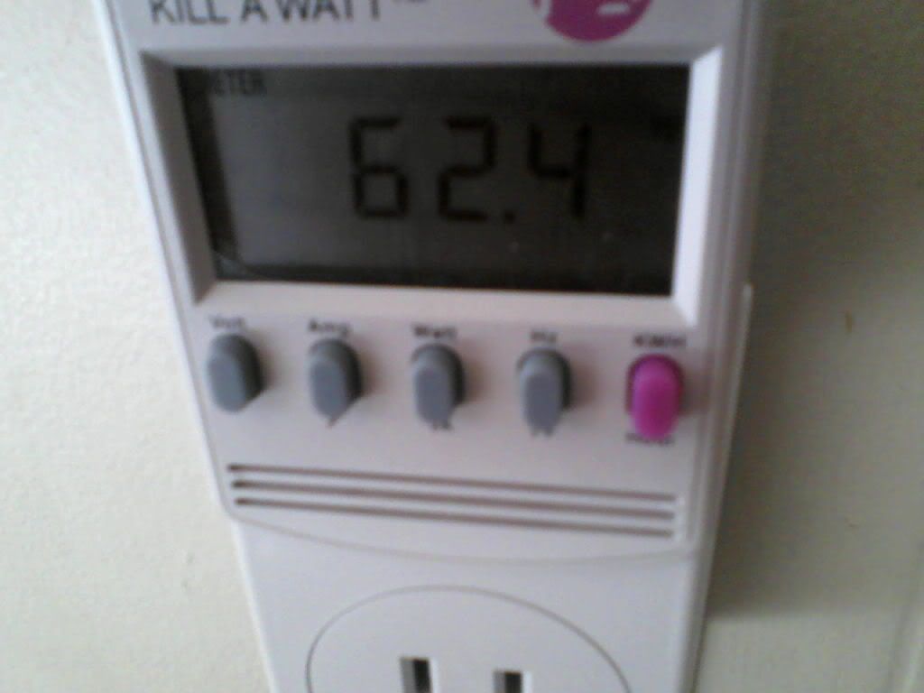

Old 12-04-11, 08:13 PM
lawrosa's Avatar
Super Moderator
Join Date: Dec 2010
Posts: 18,145
Received 60 Votes on 52 Posts
Get a kill a watt meter. $20 bucks. Every gen owner should have one.
Its the Hz. Most gens are set higher so when under load it comes down. But my gen did not and stayed up around 63hz.
the kill a watt meter ley me fine tune the governor to about 61.5 hz. At 1/2 load it brings it to the 60 hz I like to see.
I constantly monitor this meter when under emergency power. I keep it pluged at the gen or in a outlet in the home thats running off the gen.
Amazon.com: P3 International P4400 Kill A Watt Electricity Usage Monitor: Home Improvement
Here the Hz mine used to run at before I adjusting the governor and an example of the kill a watt.

Also Get a outlet tester like this. My gen has a floating nuetral. With this device plugged into my gen it shows a open ground. As it should its not bonded.
But when I plug it into my home wiring with the L14 20 you see in the pics below it now shows my gen outlets as normal. Two yellow lights on this tester all is good.
[IMG][/IMG]
Just some info for you.
Mike NJ
