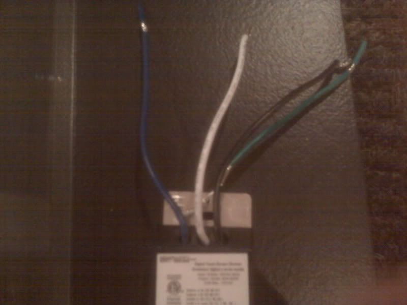

How can I wire a digital dimmer when all I have is hot and neutral?
The dimmer has 4 wires green(ground), Blue(load) black (hot) and White(neutral)
I've installed one upstairs without any issues. Now I need to install the same dimmer in one of room in my basement but all I have is 2 wires the hot and neutral from one cable. The "old" switch that I want to replace is a single pole toggle light switch.
That white* is not a neutral. It is a hot. You have a switch loop with no neutral. Easiest solution is a dimmer that doesn't use a neutral. Second easiest is two replace the 2-conductor switch loop cable (black, white, ground) with a 3-conductor cable (black,red, white, ground).
*A white wire used as a hot in a switch circuit by code must be recolored some color other then white green or gray but often that isn't done.

I can't re-run a new cable those digital dimmers came in a box of 2 I have installed 1 and I need to use the other one somehow since I can't return it. So basically what you are saying is I can't use that dimmer with the wiring that I have?
Yes. Plan C would be to run a cable from a near by power source such as a receptacle* to the switch box, disconnect and abandon in place the existing power in cable at the light and feed the light power from the switch using the existing cable from switch to light.

That is a 3-way dimmer. You just need a simple cheap single location dimmer. Sometimes a 3-way dimmer can be used as a single location dimmer. I don't know about yours but I doubt it because of the silver screw.
other Hot(neutral [sic]) on the silver screw
No. Please stop right now and recolor the white wire black or red with a magic marker so you stop confusing yourself by thinking of it as neutral. The silver screw on that dimmer probably needs a neutral. Go back and just get a simple single location dimmer.
