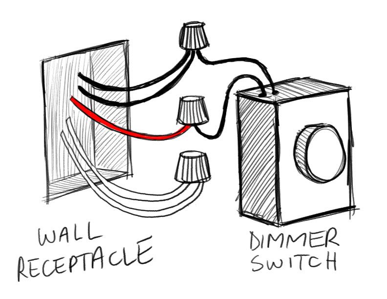

this is a diagram of the original configuration which still worked but was blinking intermittently because of the two black (hot) wires from the receptacle being loose:

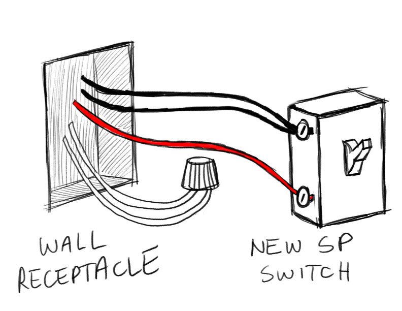

and here is the current configuration which is not working. Keep in mind that it *was* working before I pushed the new switch back into the receptacle and tightened everything up. (The receptacle was a little bit loose).
I am unable to get anything going now. Neither the dimmer nor the new on/off switch is working nor are any plug outlets further 'downstream' working.

You really should not have two wires under the same screw but use the wire nut to splice the two plus a short "pigtail" and connect the pigtail to the switch.
At this point I would suspect that you somehow caused the white wires to lose their connection. Having aluminum wiring is already problematic.
Do you have any kind of electrical testing equipment?

I'm confused by your use of the word "receptacle". Do you mean the electrical box that contains the connections and the switch? The term receptacle is most commonly used in reference to the duplex receptacle into which you insert the plug from an appliance.
If this is what you mean, there should be nothing behind the box that could be the problem UNLESS some hack did the initial wiring.
As to the white wires...aluminum conductors are a proven hazard unless they are properly connected with approved methods. It IS possible that in your opening up this splice that you caused a high-resistance joint when you re-spliced them OR you could have even broken the conductor when you replaced the wire wire nut and/or taped the joint or pushed it back into the box.
