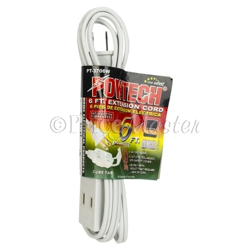

Perhaps I could load test these? Place a space heater or appropriate max amperage load on them, then after 10 minutes or so check plugs and wire for heat?
These are the extension cords used for Christmas lights typically or a table lamp. Just your basic white zip cord 6 ft. extension cord.
How many amps should those safely carry?
Cords like this...

The following extension cord looks just like any I have bought in the past...
UL warns of potentially hazardous extension cord...

I've had many of those pictured cords meltdown. I've also bought cords marked 16AWG, 13A, 1000W. Here they were 20AWG
Needless to say, I now only buy cords from reputable brands like Woods, Leviton, Cooper, or I make my own.

Or buy one and cut it to see what size the conductors really are. Also check the contacts to make sure they'll make good contact with the prongs while you're at it!

I've cut one marked "30A 125V HEAVY DUTY INDUSTRIAL POWER CABLE" and found it to be 18AWG with alot of extra rubber.
The best thing to do IMO is to get wire cut off a spool and put on your own connectors. Then, you KNOW what's going into it.
