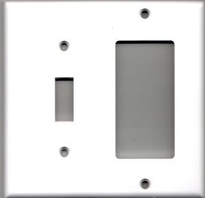

My dilemma is this. The new wall plates I bought attaches to the dimming light switch and the right
side is just a dud plate because it doesn't have to control anything. The problem I have is it cannot
screw into anything nicely like the wall plate next to it. The screws spin freely.

The Decora blank screws on to the box just like a regular Decora fixture. Then the bottom and top holes of the plate go to the Decora blank. In that case you would use a plate like this:
However it would be simpler not to use the Decora blank at all and just use a plate that has a toggle switch opening on one side and is blank on the other. You might have to go to an electrical supply to find that.
You have not shown me the front of the dimmer so I'm guessing it uses a standard toggle switch cover plate. If it is a Decora style you would use a double Decora plate.
Note: On the Decora side the screws that go in the topmost hole and bottommost hole are 1/4" long Decora screws. The inner slots are what hold it to the box and regular 6-32 fixture screws can be used there.

Then you would use a double Decora plate as shown. I'm not sure of your question. Did you use the special very short Decora screws to hold the plate to the blank.

I had to use longer screws to attach the light switch and blank
insert into the box.
New pics
Wall plate - a set on Flickr
I need to find a thicker blank insert. Bottom right side sticks out

The thickness won't vary much - these are all engineered and manufactured to the same industry specs.
If I'm looking at the photo right and interpreting your comments right, you need some device shims. Should be at the big box. Amazon.com: Gardner Bender GSP-04 Quick Fix Electrical Spacers: Home Improvement
You screw the blank plate in part way, snap together as many shims as needed to get the right thickness, insert over the screw,and tighten to proper depth. The shim will hold the blank out at the right depth.
One problem with plastic boxes that doesn't happen as much with metal boxes is that when they are bowed, it can be very hard to screw devices in because the vertical dimension is out of spec.

Actually there are four shims built in to the Decora blank. The ears at the top and bottom of the blank can be snapped off and used as shims.
Not best practice but in the past I have left the fixture mounting screws a bit loose and used the plate screws to pull the fixture flush with the plate. Harder to do do though with Decora because of the shortness of the plate screws.
