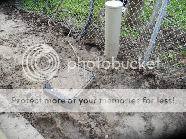

Here's a picture of the "black box". What's the correct name?
We are getting quotes today.
Old 12-28-11, 08:46 AM
pcboss's Avatar
Join Date: Jul 2002
Location: Maryland
Posts: 14,357
That is a hand hole box. .
Old 12-28-11, 04:54 PM
CasualJoe's Avatar
Join Date: Jan 2010
Posts: 9,213
Looks to me like a Quazite or equivalent open bottom junction box, but appears to be pretty small for service conductors. Have you ever looked in it? It also looks like the lid bolts are 5 sided. There are special sockets made to fit these bolts, usually two sizes fit all boxes.

123.,
That is what we called either hand hole box or quaitze box and I did catch the photo with oddball bolt head which it is a Pentagon bolt and you will need a Pentagon socket and not very many place will carry this socket.
Normally the Pentagon bolt useally reserved to the POCO or other means prevent any unathorized personales to get into there.
The only way they can find the break by two method is TDR { time deomation refactor (sp )} or Megger or using the toner to trace the excat location and dig it down and respice it with proper underground kits.

Are you sure that's customer side? That box is awful close to the pole and the fiber pedestal, unless the meter is on the pole?
