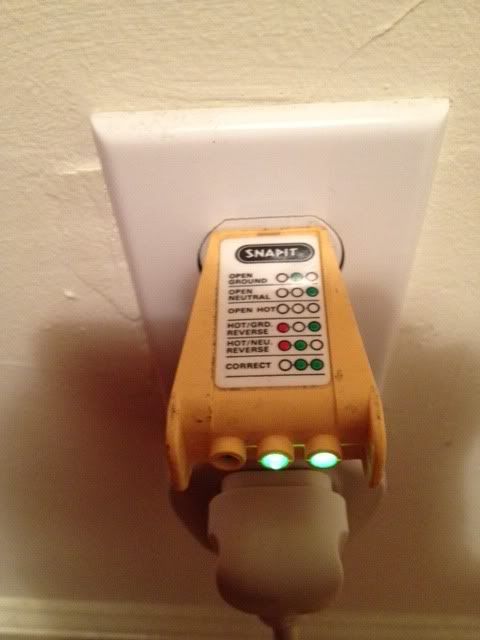

We recently moved into an old apartment (1940's) in downtown Portland, OR. From the beginning I noticed the electricity fluctuate so I plug most of our electronics into a APC 1200VA Automatic Voltage Regulator.
Recently I plugged a heater into the living room outlet and it seemed to trip a breaker. I went down to check the breaker box which seems to be relatively new (15yrs) and nothing was tripped. So I went back to the apt to investigate the outlet. What I found was ungrounded old cloth covered wiring hooked up to our newer 3 pronged outlets. I checked a couple of the other outlets and it doesn't look like any of them have a ground wire. But when I plug them into my tester it says they are fine.
I fixed the outlet that I had trouble with...part of the old wiring was loose so I cleaned up the old wires with a wire brush and reconnected everything using the screws on the side instead of the quick plugs on the back.
My question is should I be concerned about this overall set-up?

Concerned? Maybe, but if it were me, I'd rather just be aware that the wiring is 70+ years old and I would NEVER, EVER plug in a heavy load like an electric heater or air conditioner unless the wiring has been upgraded for those appliances. Most likely your apartment has one or two 15 amp original circuits for both lights and receptacles plus any updates. This is the type of thing you run into in a 70+ year old building.
If it is BX or Greenfield it may be grounded through the cable/conduit metallic sheath. Not the most reliable because of the lack of a bonding strip found in modern metallic cable. The ground provided is not a code approved ground and should not be used for receptacles with ground. The three prong receptacles should be replaced with 2 prong receptacles or GFCI protected and marked no equipment ground. You might want to let your land lord know.

You should not have three prong receptacles on older two wire systems unless the wiring method provides a ground or the receptacles are downstream of a GFI and marked "no equipment ground".
