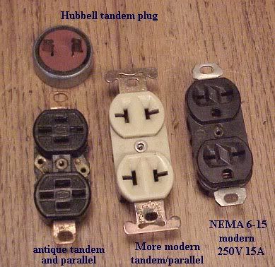

When I was a kid (long, long ago) we had a receptacle in the bathroom that was in the shape of a regular (ungrounded) duplex receptacle but it had four places to plug a cord into IF the plugs were the relatively flat plugs common to lamps.

I believe I found it, yet how do you post a picture without a link? Note: The below is an old napolian type receptacle. Same as the one I post below—in my last post.
Oh well, here it “may” be [click on the picture of receptacle]:
Does anybody recognize this type of receptacle? - InterNACHI Inspection Forum

I had one of those outlets found in the second link in an apartment I rented. I didn't know what the heck it was for. So I tried a lamp in it and it worked. I think that was the only outlet in the room.

both of the below are the same. I believe one is duplex, and the other is single.
File:Combo-outlet.jpg - Wikipedia, the free encyclopedia
and

I know what you are talking about and that is a old school quad duplext receptale they don't make that anymore historywise.,
IMO it will be wise to ditch that out due the age and the tighteness of the blades is loose and can cause the issue however .,
You have to be carefull due most older wiring in the older homes useally are not grounded so only two legit way you can do with old school wirings is use the 1-15R aka two blade recpetale or go with modern 5-15R aka three blade receptale but use the GFCI for this and use the tag say " No equiment ground " that is the only way it can meet the code.
