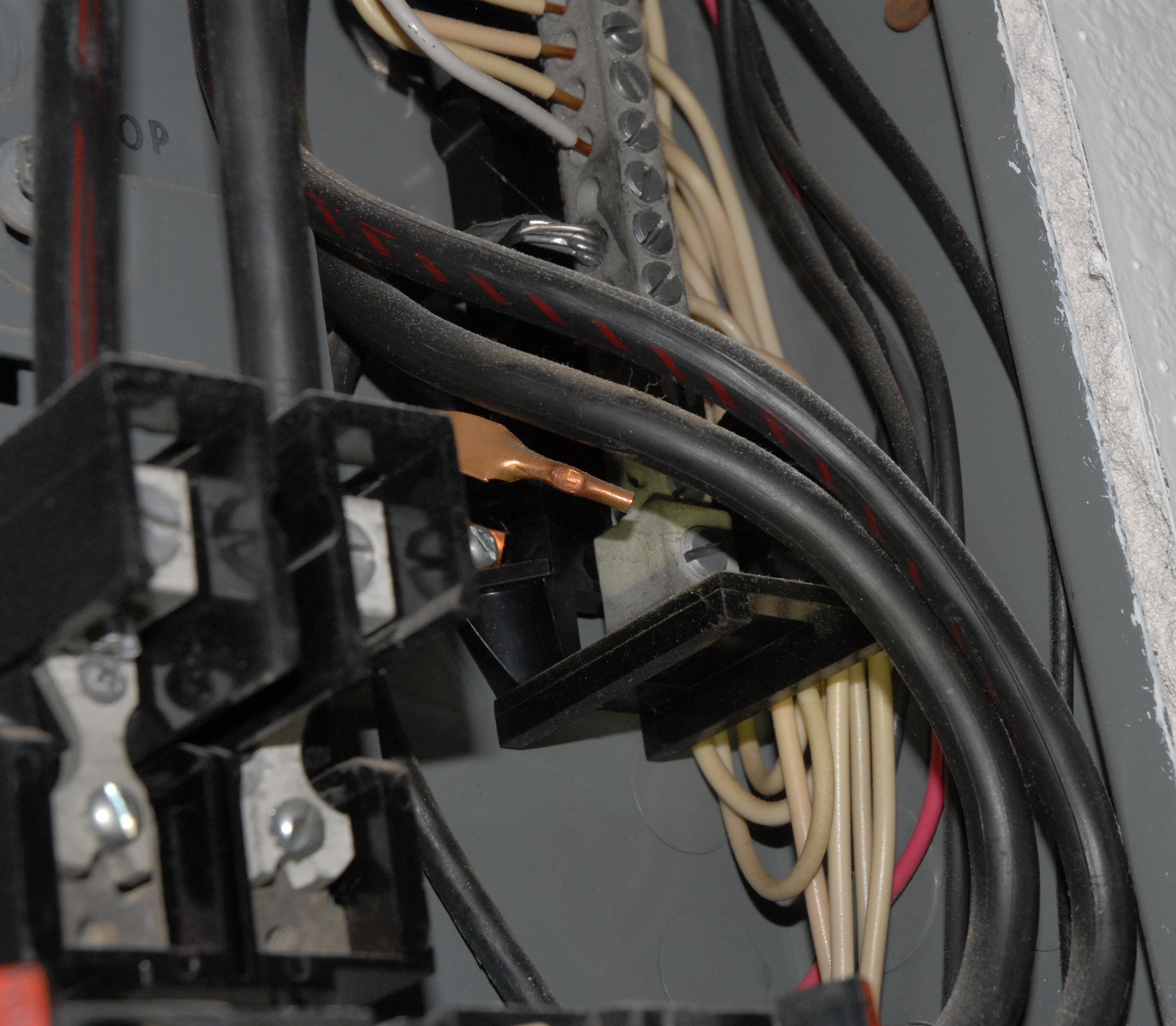

Hi I just bought a GE induction cook-top that requires 50A @ 220V. It comes with 8AWG wires.

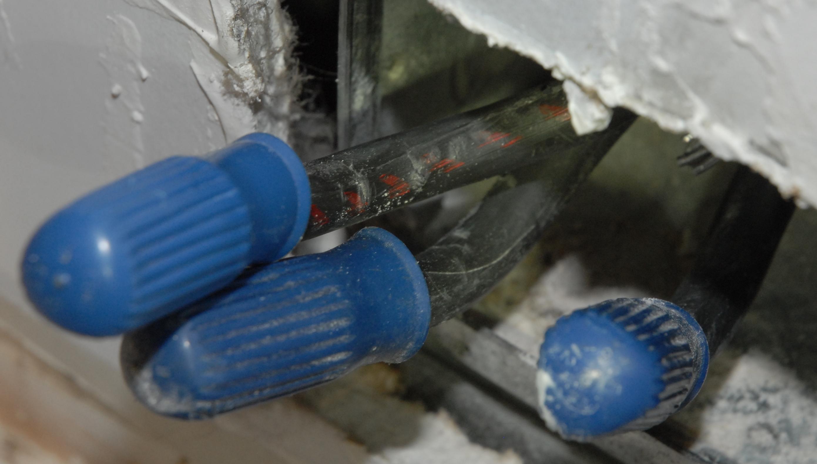

The home I bought has this outlet in the stove/range area:
It seems to me 6AWG aluminum wires. What is the recommended way to connect this cook-top to electricity here?

What type of insulation is on the AL conductors or can you tell us the cable type used?

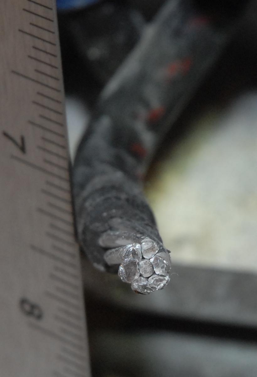

Unfortunately I do not know and there is nothing written on the insulation of the wires. Keep in mind I have bought this house few days ago and those wires were already there.
I have made more detailed photos:
Full resolution: 01
Full resolution: 02
Make sure to click on "Full resolution" to see the details.

Is that red labeling on the conductor?
Old 01-21-12, 01:27 PM
Join Date: Jan 2012
Posts: 190
It's only red "spots", nothing is actually "printed" to be read. I will check the other wires if they have something similar.

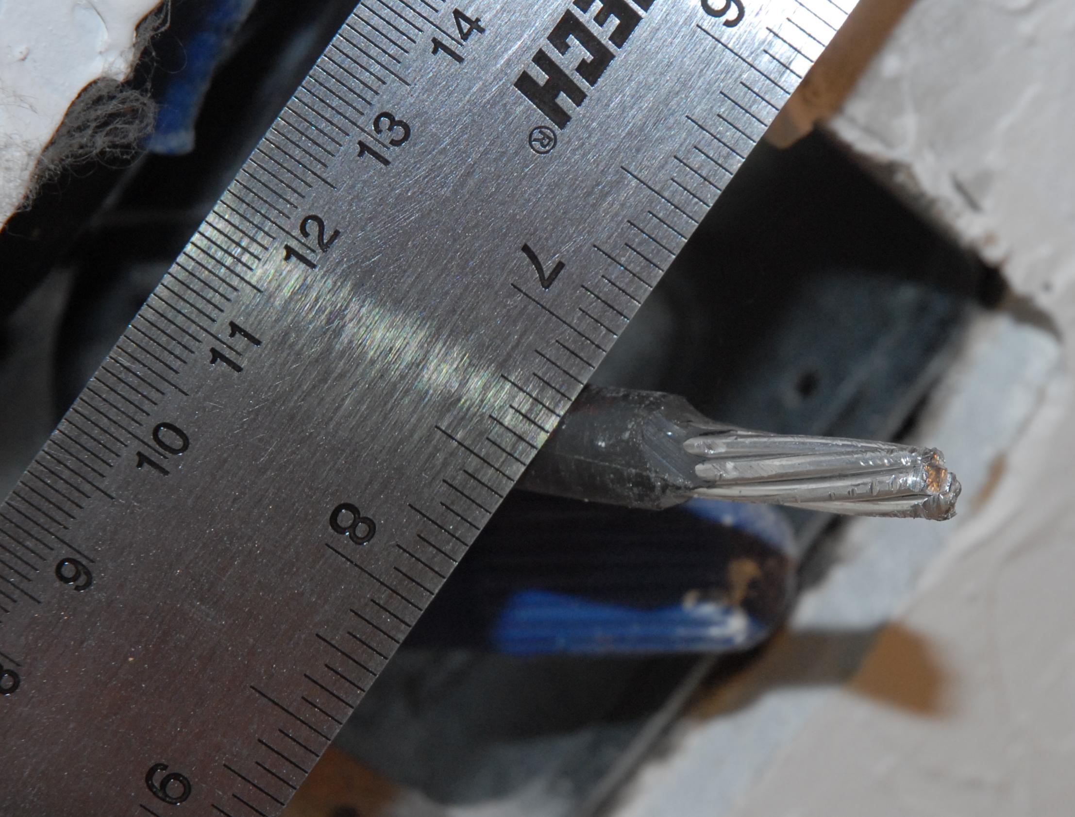

The other two wires do not seem to have any of those spots. I attach a detail of those spots in the only wire that has them. After that, I will go down to the electrical panel and see if there is anything interesting.
Full resolution: 03

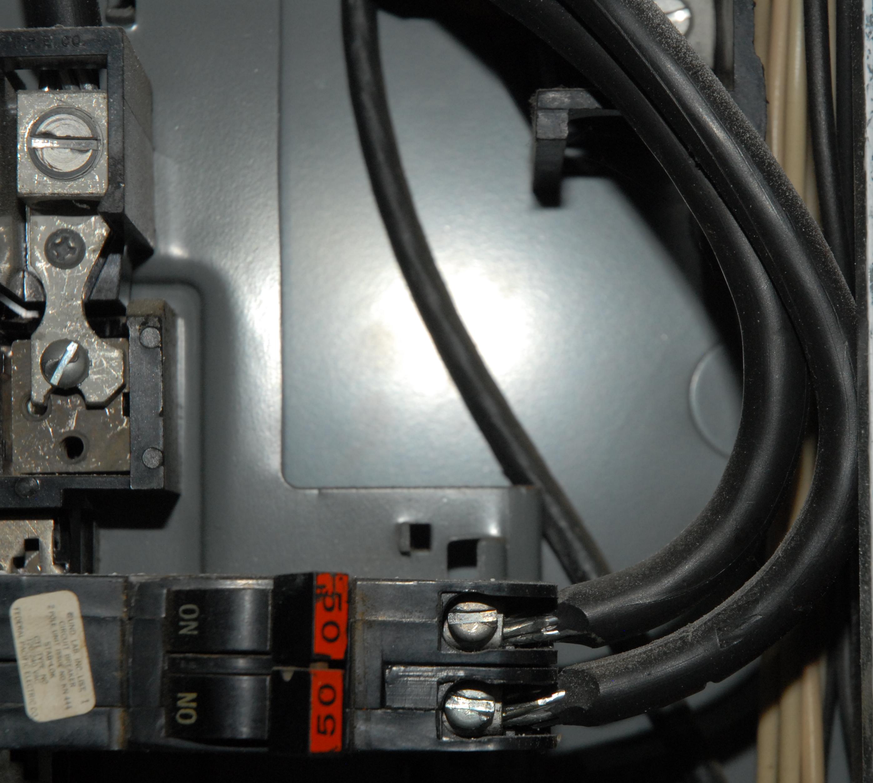

You should be able to see something on the cable sheath outside the panel. It may say something like 6-3 AL SE-R.

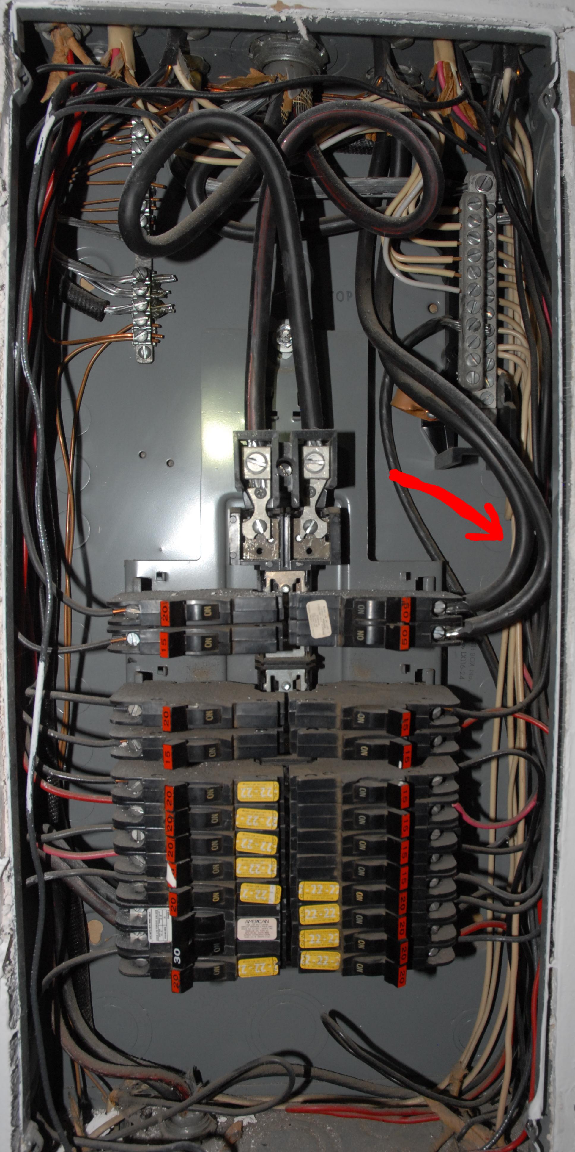

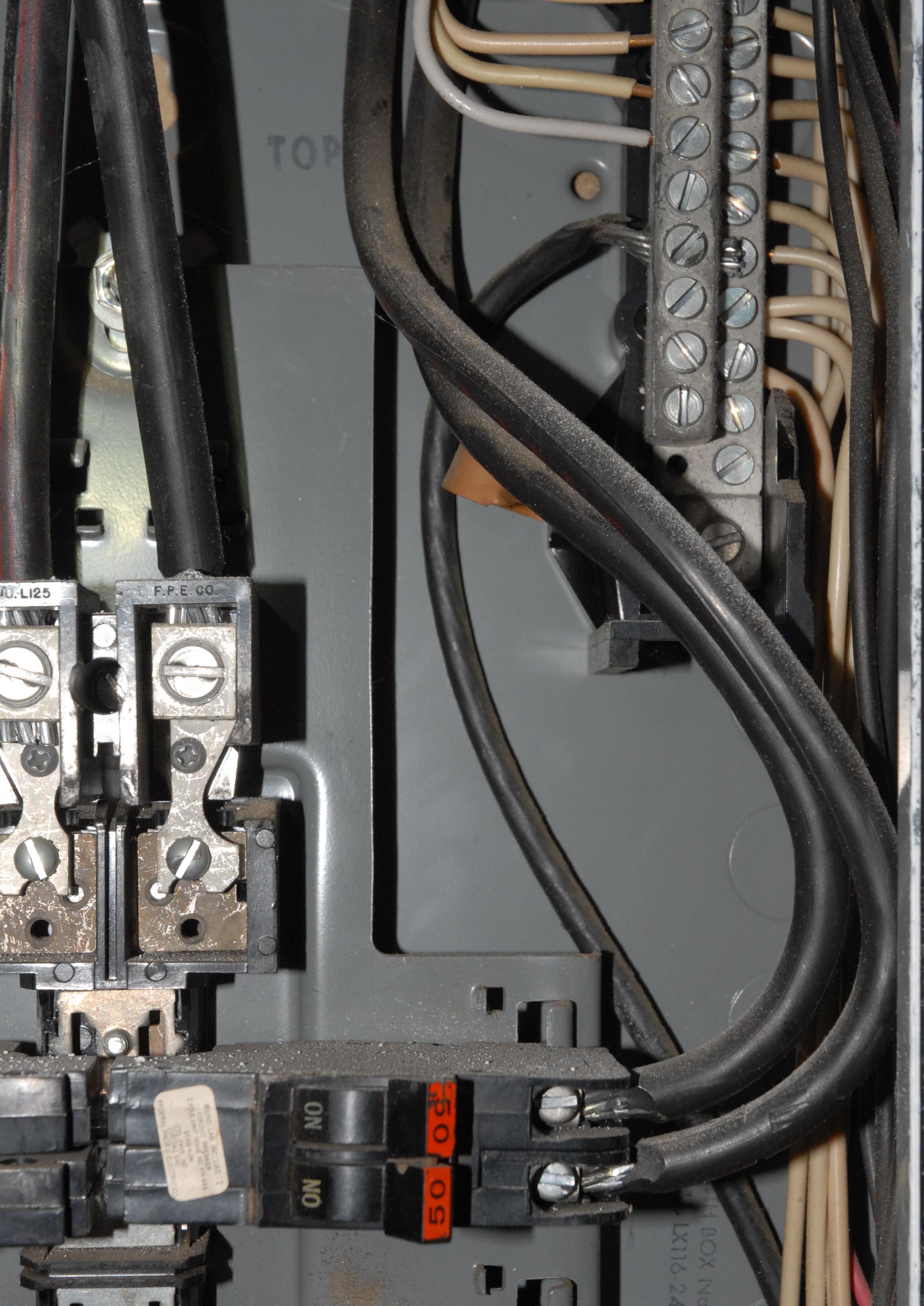

Photos of the panel
I have taken few pics of the panel. Unfortunately I cannot read any wire spec on the insulation.
Full resolution: Panel 01
Full resolution: Panel 02
Full resolution: Panel 03
Full resolution: Panel 04

Not sure if this will apply, but the 2008 code prohibits SER cable from being fused at 50 amps. You must use the 60 degree column, which will only allow 40 amps on a #6 SER. As I said in the beginning, I’m not sure it will apply in your situation. It may—seeing that you are installing a new appliance. Also, you may want to check your manufacture instructions. Some Manufactures will only allow copper for their appliances.
Personally, I will never install alum for any cooking appliance. But, that’s just me.

There was a change in the ampacity ratings that applied to SER cables.
Number 6 AL at the 60 degree column is 40 amps, at the 75 degree column where it used to be allowed to be used was 50 amps. The code is also reversing the lowered ampacities in the next cycle.
I think you would be ok to use the wiring at the 50 amp rating. You could always call your building officials and ask for an opinion.
The connectors will need to be rated for use with AL. Pre-insulated Polaris connectors are pricey but easy to work with.

A few things that bother me about that panelboard.
1. It appears to be a Federal Pacific, at least the main lugs have FPE Co molded into the plastic.
2. It has no main breaker nor does it appear to be a split-bus panel.
3. The incoming wires look rather small, perhaps it is only a 100 ampere panel?
4. The separate equipment grounding bus would lead me to think it WAS a sub-panel.

Might main breaker be outside with meter?
The neutral bar is not bonded to the panel box so I would agree, it's a subpanel. It's definitely a Federal Pacific panel, perhaps fed with 100 or 125 amps.

And probably a US not Canadian FPE panel. Alesan here is some info on FPE panels made in the US. Federal Pacific Panels and Associated Danger | U.S. Inspect

Ray is absolutely correct! You should put panel replacement high on your priority list as you plan future projects. Here is some more information on FPE.

Yes this is a 100A panel and the 100A breaker is outside.
Guys, I really thought 100A was an enormous quantity of current
Within this year I will remodel this part and I will surely put a lot of attention to the electrical wiring.
For now, I will check the connectors so at least I'm able to cook dinner

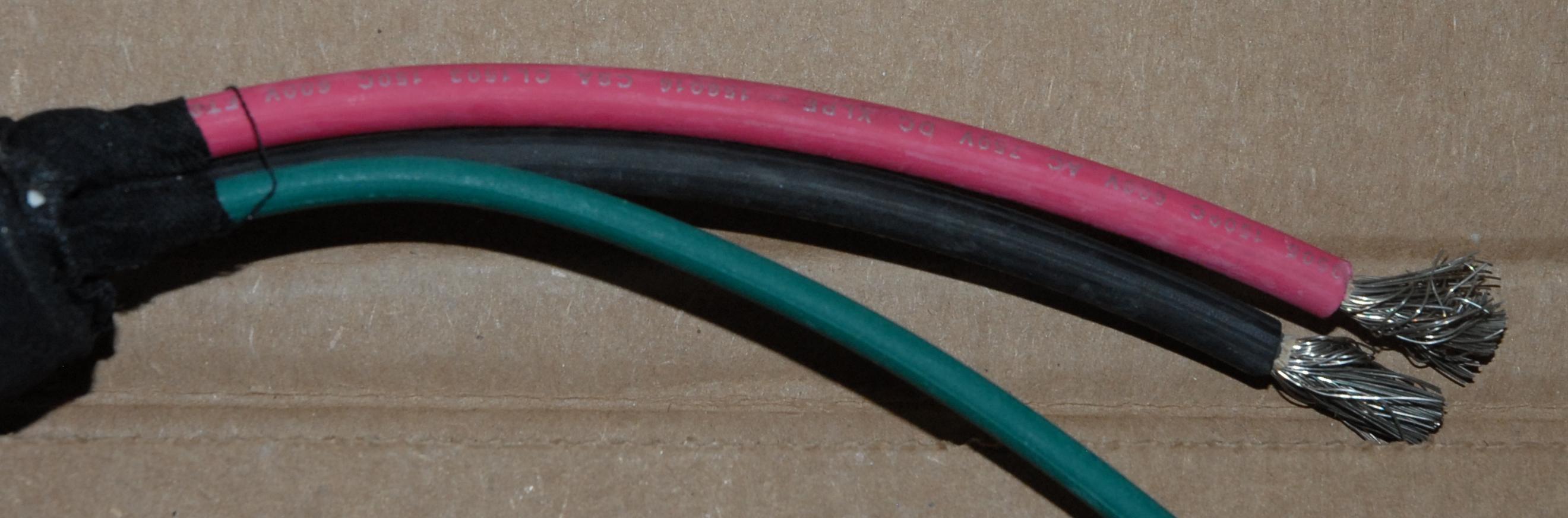

Hi I opend up the wall because I need to change some wiring anyway; I could see the jacket of the cable and it says:
"Type RHW *DRS 300 Volts to ground"
(The * is an unreadable character)
I could not read a gauge measurement. Any idea what is that cable?

I have a feeling the missing character is a C for conductors.

Later this evening I will post a picture so it's easier to understand. I was thinking to replace this thing anyway with regular copper, as I already have to buy NM-B 6/3 for the oven installation. What do you think?

I think I would replace it.
