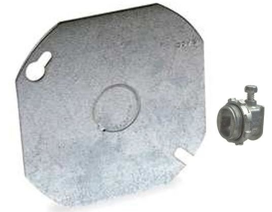

Let's assume we figure out if I need 3 or 4 conductors; what about the best way to close the box and the sheath? I tried to look for pictures all across the web but could not find an example
The white and green are connected for an older 3 wire installation. If you have 4 conductors you would split the white and green or bare into their respective colors and splice.
While Ray shows an 8B cover I would use a 4" square deep box and cover. I also don't like using a center knockout in the cover.

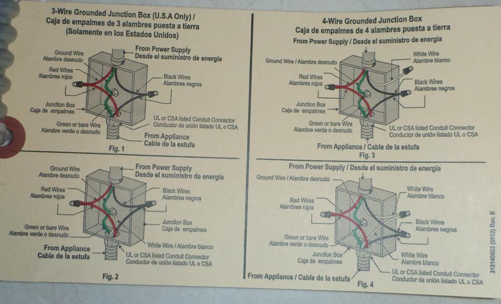

I now include the instructions and some pictures.
These are the instructions found on the label; I am not a Native English speaker, and I find this label pretty hard to understand. The appliance is a Kenmore "Made in Canada" probably they use a different slang over there.
If your appliance is equipped with a white neutral connector:
This appliance is manufactured with a white neutral power supply and a frame connected copper wire. The frame is grounded by connection of grounding lead to neutral lead at the termination of the conduit, if used in a new branch circuit installation (1996 NEC), mobile home, recreational vehicles, or where local code do not permit grounding trough the neutral (white) wire, disconnect the white and green lead from each other and use ground lead to ground unit in accordance with local codes, connect neutral lead to branch circuit-neutral conductor in usual manner see Figure 4. If your appliance is to be connected to a 3 wire grounded junction box, where local code permit connecting the appliance-grounding conductor to the neutral (white) see Figure 2.
If your appliace is not equipped with a white neutral conductor:
Connect only to a 3-wire, 120/240V power supply,; the neutral conductor is not required for the operation of the appliance. The potential at the power supply electrical connections shall be 150V to ground or less. See figure 1 or 3.
Figures (higher resolution photo):
Picture of the wires. Note that the green and white are "taped" together (higher resolution photo):
My understanding at this point is that I need to run a 4-wire cable.
Figure 4 of your picture is correct for a four wire circuit.

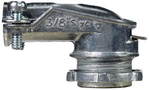

Note while I showed a straight MC connector a 90° connector would be better. Trying to get the MC to conform to the radius of the MC is difficult I think PCBoss was suggesting a surface mount box with the MC out the side. A 4" box as he suggested gives you more room.

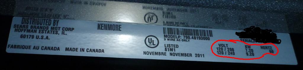

OK I have checked all the oven inside and outside and I have only found this label (full resolution):
Bottom line it says 9.2kW that at 240V it's about 38A accoding to ohm's law (an oven should be a mostly resistive load).
Suggestions? Should I get a 50A breaker and wiring??
#24
You would have to use a 40 a breaker on # 8 and while the oven might never draw full amps it is best to go to the larger feed. For the record most ovens are on 40a circuits. You might want to look at the owners manual to see what is recommended. You could use #4 aluminum SER or individual #4 aluminum wires in conduit.
