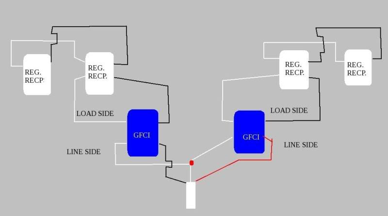

I am trying to wire additional outlets in my garage. My idea was to run the outlet off of one of the two existing I had. I was going to connect the wire from the breaker to both terminals using wire connectors. This was assuming that 14/2 had been run to the outlet. When I removed the existing outlet I saw it was actually 14/3 run to the outlet. The red wire is connected to the hot terminal on the outlet. The white is spliced in a wire connector and goes to the outlet and a 14/2 wire. The black from the 14/3 goes to a wire connector and the 14/2 wire. The Ground is connected to the box and then the plug as expected.
Also, these two plugs are on two seperate breakers. My thought is that the two hot wires connect to the individual breakers and share the neutral wire. If this is correct does that mean I can just connect the new 14/2 wire to the existing wire connectors going to the other plug?
I've included a diagram of what the current setup looks like. Any help is appreciated.

Is the breaker a 240v breaker or two single pole breaker? If single pole breakers make sure there is 240v between them. Note the receptacles must be GFCI protected.

there are two 15A breakers with a connector over the switch. So if I turn one of, the other needs to be turned of.
That is a two pole 240v breaker so you are fine. Each of the first receptacles after the split must be GFCI. The rest regular, non-GFCI, receptacles, daisy chained from the load side If you need more info post back.

Thanks for the update. So would I need three GFCI receptacles? 1 for each of my existing, and then one for the first new one I add after the split? I've updated the picture, let me know which ones would need to be GFCI.
Also for the 2nd new receptacle, can I add it by using the second terminals on the receptacle or should I use wire connectors as I illustrated. Kinda confused by what you mean daisy chain.
No. You need a GFCI on the red wire circuit and on the black wire circuit.
That would be one GFCI.
he white is spliced in a wire connector and goes to the outlet and a 14/2 wire. The black from the 14/3 goes to a wire connector and the 14/2 wire [cable not wire].
The first receptacle on that cable would be a GFCI.
Simply means cable is run from the first receptacle to the second receptacle and then from the second receptacle to the third and so on.
The first is your GFCI and so the second would go to the load side of that receptacle.
Your picture doesn't work. I tried to correct it but you have the wrong file format. http://www.doityourself.com/forum/li...-pictures.html
Will try to post a quick and dirty diagram for you later.

This is a very bad diagram compared to yours but see if it helps you a bit. If not I'll try to do a better one.

Thanks Ray! Got everything up and working. It is pretty well how I thought it should be, was just not expected the 14/3 wire. Thanks for all the help and I'm glad I found this forum.
