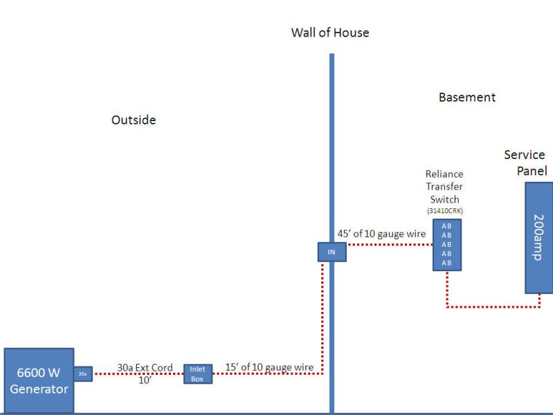

My design (poke holes early and often please):
Here's a rough sketch of what I'm thinking:
I have a 6,000W generator (11,000 starting watts) and am in the process of planning out which circuits to hook up.
Please respond back with any questions or feedback.
Thanks!

The only hole I can poke is your inlet box appears to be floating in space. Were you planing on mounting that to a garage wall or something? Where/what is the first 15' of #10 cable going through?
I only see one issue. The inlet appears to be in a raintight box with weatherproof cover, but the cover is no longer weatherproof if the cord is plugged in. This wouldn't be an issue if your outages are all during dry weather.

Thanks for the feedback! Forgot to mention Im just a normal DIY'er and no expert so really need the help here.
Tolyn Ironhand - great screen name BTW! I'm planning on mounting it right next to my breaker panel in the basement. Like 3 inches to the left. The first 15' of 10# wire will be outside and I'm planning on running it through PVC conduit. I assumed that's ok.
CasualJoe - i was wondering the same myself. Im very concerned b/c, to your point, many of my outages are in rain and snow. So, my plan is to have alot of this underneath my deck. I know that my generator needs sufficient room to exhaust. The deck is about 8' high. underneath the basement of the house borders two sides. So the other two sides under the deck will be open to the air. But...my expectation is they will receive less hard weather. I'm thinking of running a small tarp over top, technically underneath the floor of the deck, to further keep rain out.
Auger01 - thanks for that link. I'll have to use something like that to keep the inlet dry. And to your point about an interlock, yes! I did hear of those and that really sounded like a better idea. but i know they're not allowed in some states. And both an electrician that came out to quote doing this for me, and the utility guy, never heard of them when I asked them about it. And its not a the type job I'd be comfortable doing from what I've read.

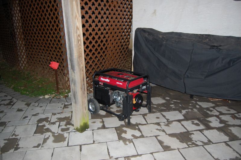

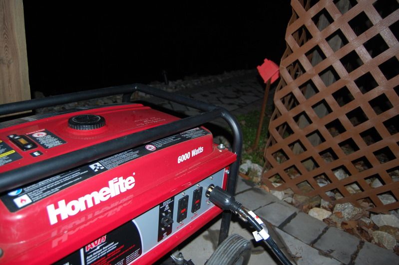

When in use the generator will be rolled out of my basement put into service outside the basement wall, underneath the deck.

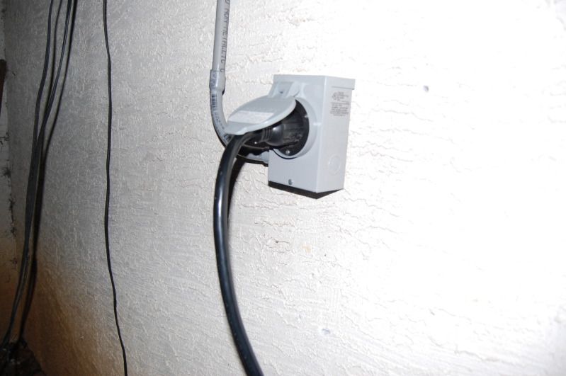

The 10' ext cord plugged into 30Amp outlet on Generator

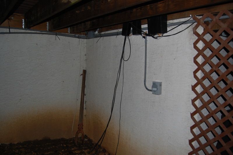

Inlet box is located underneath my deck:

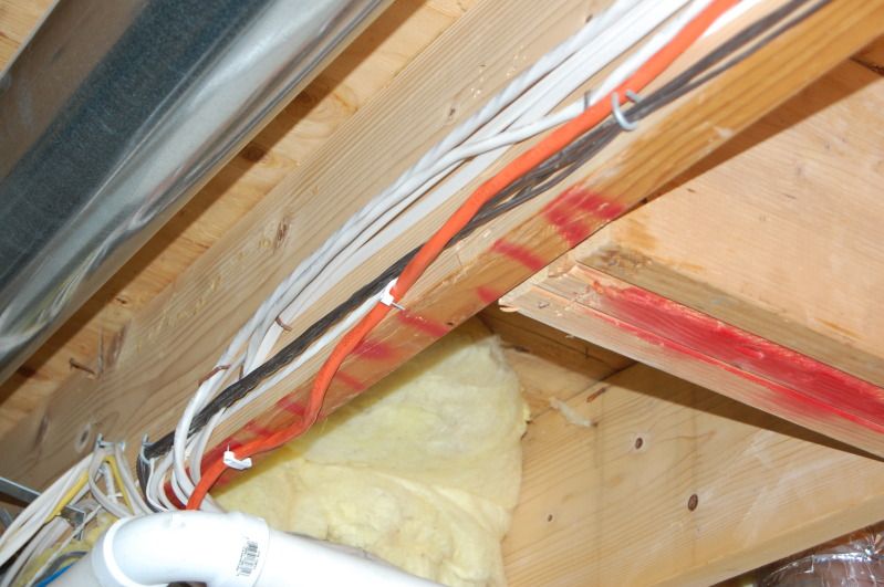

Here is where I started the run of 10-3 building wire insulated in 1/2" PVC. I purchased a roll of 100' which was the max run I could safely use here.
This wire was really tough to work with.
In hindsight I should've used 3/4" pvc at least.

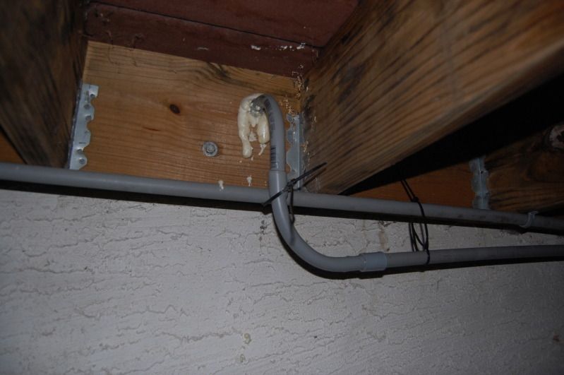

This is where it entered my house. Had to drill through the deck header, the stucco and the wooden house header. Was happy when I found I didnt have to drill through a cement foundation.
Here's the other side, where it enters the house

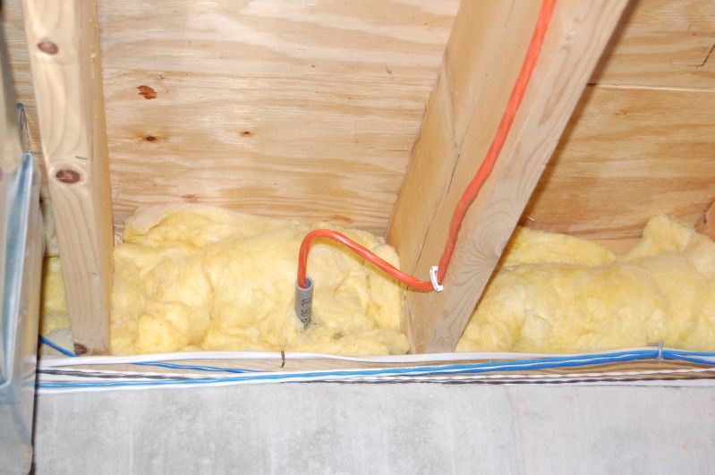

Then ran it through my basement...

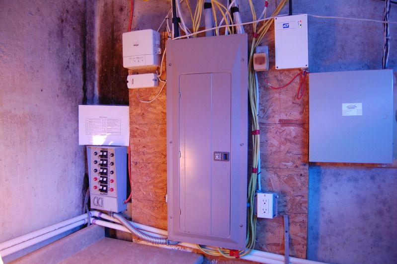

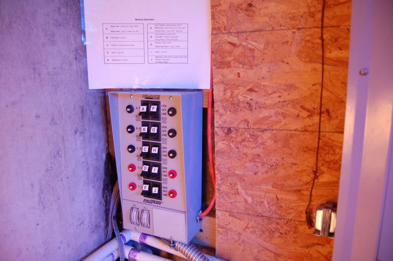

...on its way to the Transfer Switch
and into the service panel
I made up this to indicate which circuits are powered on my main panel

Good but. Don't you hate buts?
It would be better to have an in-use cover on the inlet. You seem to have used SO cord for connecting the inlet to the transfer switch. I don't think it is approved for that use. It should probably have been UF-b.
:-) Yea, dont you! But hey, thats why Im here and why I'm so grateful for this forum and feedback like yours. So
1) Yep, CasualJoe above mentioned the cover on the box. I went to home depot and found one for maybe $27. The guy there said what I had was just fine (I brought it with me to compare). So do you think I really should have the one with the bigger cover? It's already under the deck. Its no problem to upgrade if its worth it.

Ray, it looks to me like he used 10-3 NM-B cable in 1/2" PVC conduit between the outdoor inlet and indoor transfer switch.

- yep, I used NMB wire. good catch on the orange wire. I truly thought if you have it encased in pvc it was fine.

so here's what I need to do:
1) install proper covering for inlet box. I know the exact one to get.
2) correct outdoor conduit. I've seen the MC cable so I knwo what it is. Will have to check out THWN wire as well. then I'll replace the 15' or so from inlet box to where it enters the house with correct conduit for outdoor use.
3) support under deck. I wasnt sure what to do here so good to get the right feedback. I'll use 1-hole straps for sure.

You can salvage most of the NM-be. If the run is protected, and it seems to be, you could just replace the NM-b under the deck with sunlight resistant UF-b with out adding conduit. Just put a Jbox inside the basement for the transition.
