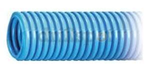

I need to install a new bathroom fan - it's got a light, night light, and a fan with two settings (auto, manual). It's connected to a triple switch where one switch has three settings, so I need to run 4 hot wires from the switch to the fan, plus neutral and ground. I asked around at HD but they didn't have any 14/5 NM-B
So what's the right way to wire this? Run two 14/3 NM-B cables and wire the neutral and ground together on both ends?

Easiest is to use ENT flexible conduit and THHN wires.

Is the double 14/3 idea not allowed by code, or just not as easy?
It would work but the connection box on the fan usually doesn't give you much room for wires. The ENT would be fewer wires in a small space.

Makes sense, was thinking about the space issue too. Thanks!
