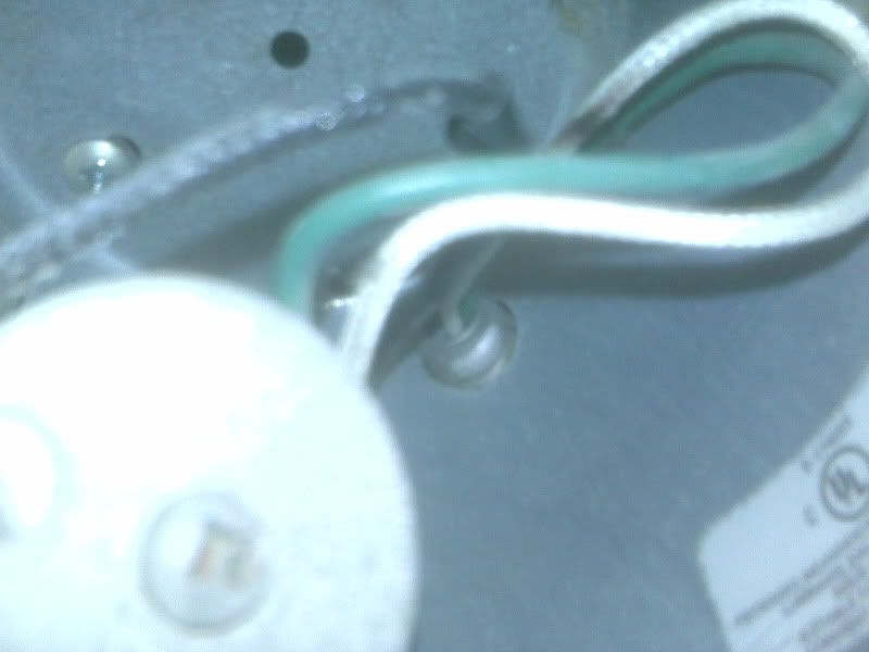

I bought a LED fixture that fits in a 4inch can
EcoSmart Ecosmart 4 In. 9.5-Watt (65w) Led Downlight (E)* Eco4-575l Eco4-575l - Compare Prices and Reviews on EcoSmart ECO4575L Shower Curtains & Accessories at PriceGrabber

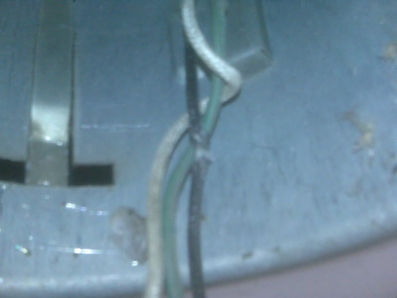

The thing is when I pushed the fixture in I niked the black wire from the can's socket. What should I do replace the socket or should I just take the can's socket out and also the LED socket out and use marettes? The thing is I don't have much cable from the box the romex is about 6 inches long and was cut to length!!!

Cut the wire at the damaged spot and re-splice with a wirenut.

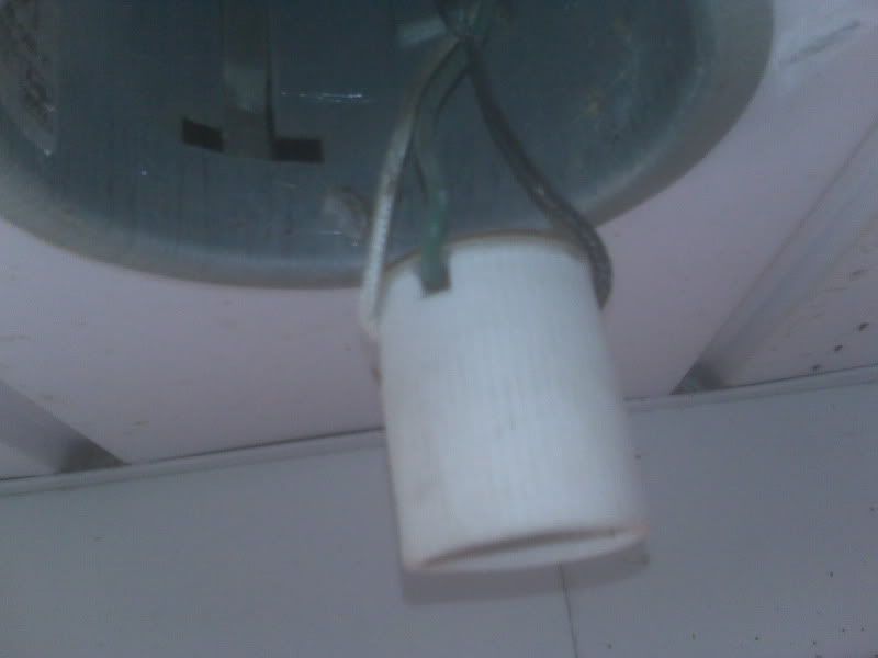

Just the black wire or should I cut all 3? I think the socket takes too much space and the LED doesn't sit properly. I wonder if cutting all 3 wires and by passing that socket would be safe? I'll try your idea thanks.

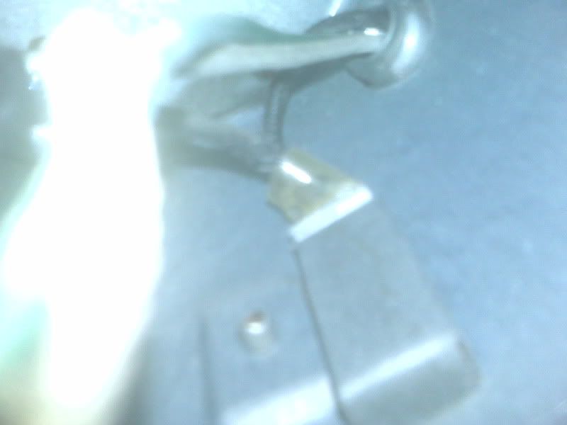

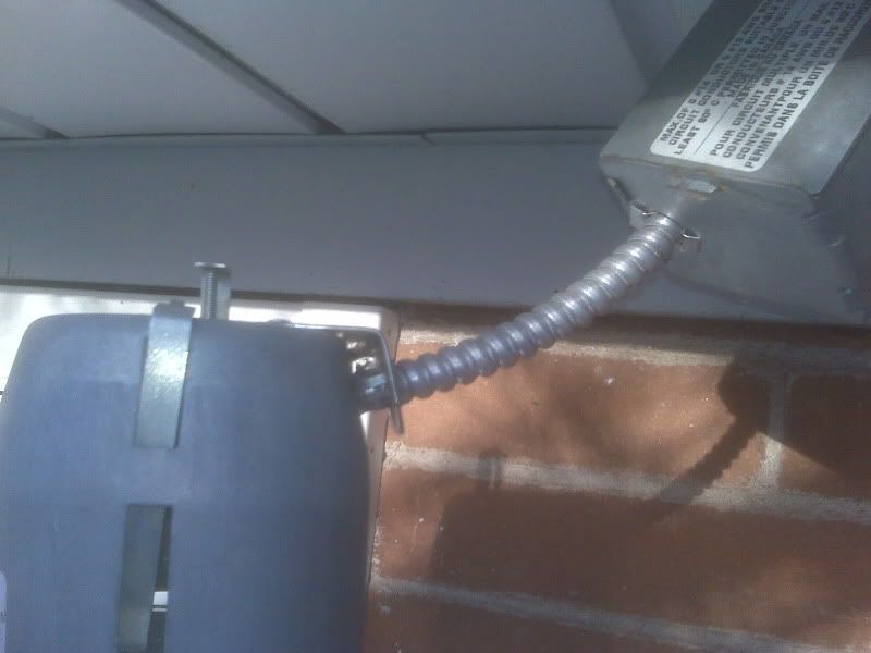

I have 2 more questions
What is that silver aluminum box? It seems sealed
Also why is the black wire looping through a small "box" inside the can?

That small box should be the thermal sensor that shuts the light off if it gets too hot.

The label on the larger box reads, "Max of 6 #14 or 6 #12 AWG branch circuit conductors suitable for at least 60 C permitted in junction box. Made in Canada."
You should be able to make the splices inside the box, but don't bypass the thermal sensor.

What's that larger box for? Is it just an enclosure?

I would not splice the conductor that is damaged. The wiring has a high temperature insulation that regular wiring does not. Since the fixture is out of the ceiling I would replace it.
The larger box is where your splices to connect to the building wire are made.

I'd cut the wire, use an uninsulated butt splice, give it a fibreglass sleeve (like you find in a heating appliance) and cover that with some heat-shrink tubing.

How do I open the splice box? That thing seems sealed and there's no screws either. Also the romex connected to the can seems to be fixed there's no setscrews or anything to disconnect the romex from the can
Old 03-14-12, 09:19 PM
Join Date: Mar 2006
Posts: 18,471
Received 16 Votes on 14 Posts
Many splice boxes have a spring clip that can be moved by your thumb and then allow the cover to be removed.

I went to 3 different stores today and couldn't find a 4" can replacement. I was thinking to replace the female socket but the only sockets I found have no ground

Bulb sockets are typically only 2 wires, without a ground. The fixture itself normally provides the grounding means or tail.
