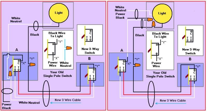

Hello BLD
Here is a quick Drawing that I made. That I think will work for you..
Also I wrote a few directions on how to wire your switches.
Follow Rays picture on how to connect the Ground Wires
You can use all the existing wiring as is. But of course you still need to run a new 14/3 or 12/3 cable from the location of the existing switch to the location of the new switch. Suppose "X" and "Y" represent the two existing wires connected to the existing single pole switch. Buy a pair of new 3-way switches. Put one (called switch "A") at the location of the existing switch.
Put the other (called switch "B") where ever you want the new switch. Run a new segment of 14/3 or 12/3 cable between switch "A" and switch "B". Connect "X" to the common screw on switch "A" (common screws are usually black in color). Connect "Y" to the black wire of your new 14/3 or 12/3 cable. Connect the red and white wires of your new 14/3 or 12/3 cable to the other two screws on switch "A". At switch "B", connect the black wire of your new 14/3 or 12/3 to the common screw, and connect the red and white wires to the other two screws. There may be other wires in box "A" not shown in the drawing. (white neutral wires twisted together or Green Grounding wires. Leave these wires alone. DO NOT MESS WITH THEM. )
If the “Y” wire happens to be white, mark the ends of it “BLACK” with a marker or tape
USE 14/3 + Ground for a 15 amp breaker
USE 12/3 + Ground for a 20 amp breaker
Hope This Helps
Have A Nice Day
Linesman

Linesman, that's thw way I would do it, with one slight difference. I would tape-tag the white wire in the new cable black and splice it to the hot feed wire. I would tie the red and the black wires on the new cable to the terminal screws on each switch. At the existing switch location, I would splice the neutrals as you have shown and terminate the load hot wire to the point screw on the new switch. At the other box, I would terminate the white wire from the new cable to the point screw on the new switch there, after tape-tagging it black.
IOW, I would convert the neutral to a current-carrying hot wire and retain the red and black as the travelers.

Linesman's picture and instructions are fine, unless you are in a location that uses the 2011 code. Then a neutral is required in every switch box.
For more info about grounding switches to metal boxes see 404.9(B)(1) (2008)
