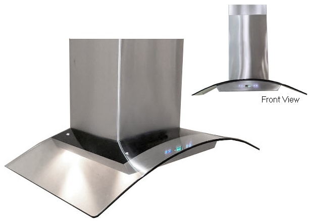

I am sorry for such a late response. We should be working on hanging the hood today, we had to get some tools for cutting of the stainless steel chimney yesterday. Here is the picture of the range hood area.
I am attaching link to the hood.
The stainless steel chimney cover can be unscrewed. Does that count as accessible?
Thank you
I'd say so but wait for the pros on that.
Old 04-01-12, 07:32 PM
Join Date: Mar 2006
Posts: 18,356
I'm going to go out on a limb here and state that IF the cover is readily removable using only ordinary household hand tools (screwdriver, pliers or adjustable wrench) then it is probably okay. Only your LOCAL building and/or electrical inspection office can give an absolute answer.

Two questions: Do you have a SPAGNA VETRO 30-inch Wall-Mounted Stainless Steel Glass Range Hood - SV218D-30? And what does your installation manual tell you about the electrical supply and connection?
Old 04-02-12, 08:43 AM
Join Date: May 2010
Posts: 17
It is Cavaliere
Here is link to the product with an Install Manual below the Description as a link. I am not able to get the correct url as it is a javascript:
Cavaliere-Euro SV218D-30" Wall Mounted Range Hood with 6-Speed and Timer function
The manual is very limited to an installation information and does not talk about a receptacle. We can't hire an installer right now due to our very limited budget.
Thank you
Old 04-02-12, 09:13 AM
Nashkat1's Avatar
Join Date: Mar 2012
Posts: 8,470
No wonder you're confused! Taken together, this:
6. Disconnect main electrical supply, prepare and run electrical wiring through ceiling or wall. Leave approximately 12 of electrical cord hanging from the ceiling. Do not restore power until wiring is completed.
7. Disconnect power cord,
and this:
9. ...connect power plug to the 12 hanging electrical cord, and connect...
don't seem to add up. It sounds like they're asking you to connect a plug to a whip.
Not to mention that the instructions are for an island mount, not for a wall mount. I think it may be time to call a pro.
