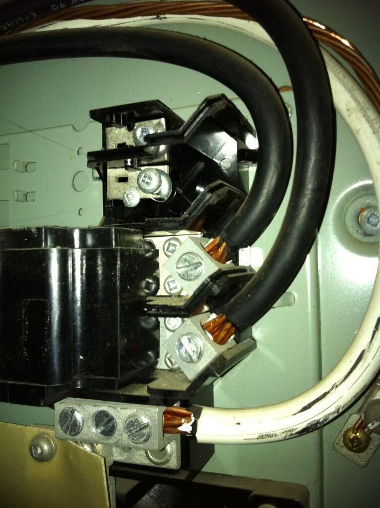

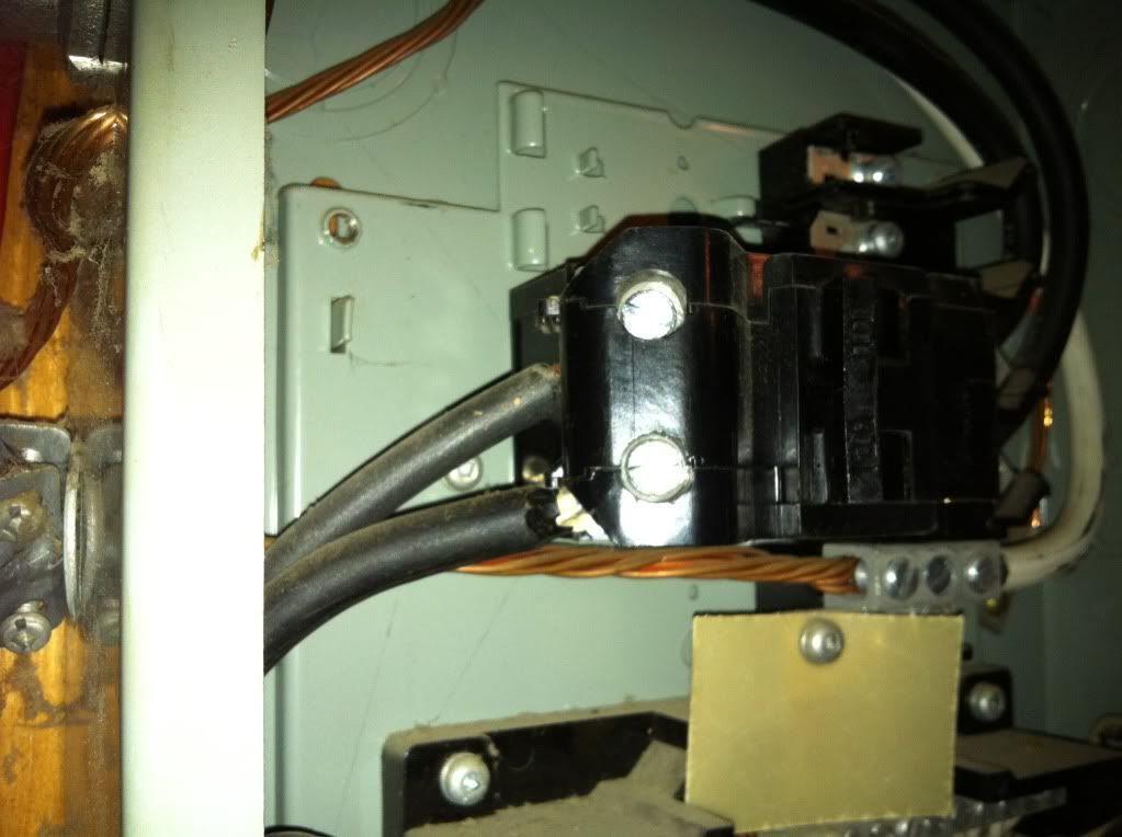

OK so the tank is working with new 240v elements 10/2 30amp breaker.
I noticed the amp draw on the hot water was s16 to 17 amps and the 20 and 22 amps on the supply lines before the main.
One of the supply lines from the meter to the main then from the main breaker to the bus bar was considerably warmer than the other feed wire. Could this disparity be causing the main to trip?
Possibly, but the breaker or connections could be causing the wire to heat up as well. I would suspect the later.

I suggest checking the wire connections. The heat from that can cause the main to trip even though there is no over current. This can only be done with the power off at the meter. The power company may do this free of charge.

All the connections before and after the main are tight.
