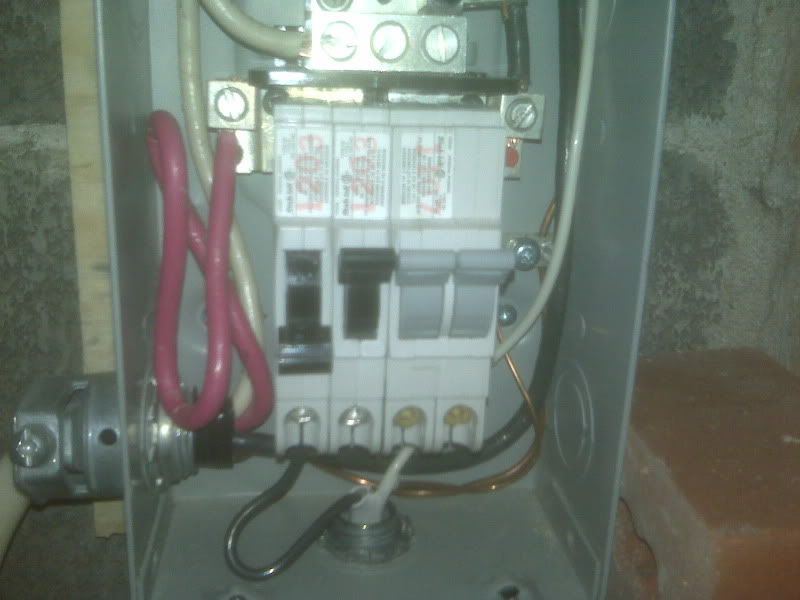

So it is a double 40A breaker at both ends!!!
The only thing is he installed it upside down the cable was too short First pict I turn the camera around

Panel is too small really for you purpose. Probably a 12 position 100 amp main breaker panel is better. Is the large red and black wire connected to the 40 amp breakers? Please step back and give us a picture of the rest of the breaker box.

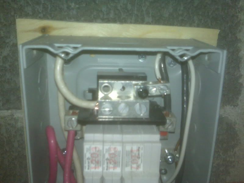

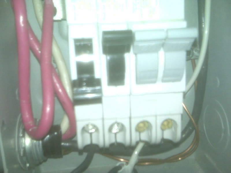

Here's more pictures
All I really need is 2x15A but since I mentioned I would eventually get a welder he offered to install a double 40A
The panel got installed upside down so the 2 black breakers on the left are the 2 single 15A and the 2 gray breakers on the right are a double 40A

Not sure which ones are the 40 amp breakers but they are doing nothing for you. You have a main lug panel.
Your panel has a minor code violation (if there is such a thing) of being mounted upside down. The breakers are required to be "ON" in the up position. This might not be required in Canada as I have seen more panels mounted sideways on "Holmes on homes" which I believe is filmed in Canada.

I am just assuming you are in Canada since you are using a Federal Pioneer panel. I don't know about the codes up there, but the NEC doesn't allow a panel like that to be installed upside down unless it is specifically stated that it may be. I suppose you noticed that the handles on the breakers are now in the down position when "ON" and up position when "OFF".

There are at least two things that are really screwy. First, of course, it installing the panel upside down, especially since it appears that there was more than enough cable to install it correctly by just using a different knockout for the cable.
Second is that it appears that the wrong type of clamp was used to secure the cable.
Just these two things alone tell me that your General Contractor is NOT qualified to do electrical work.

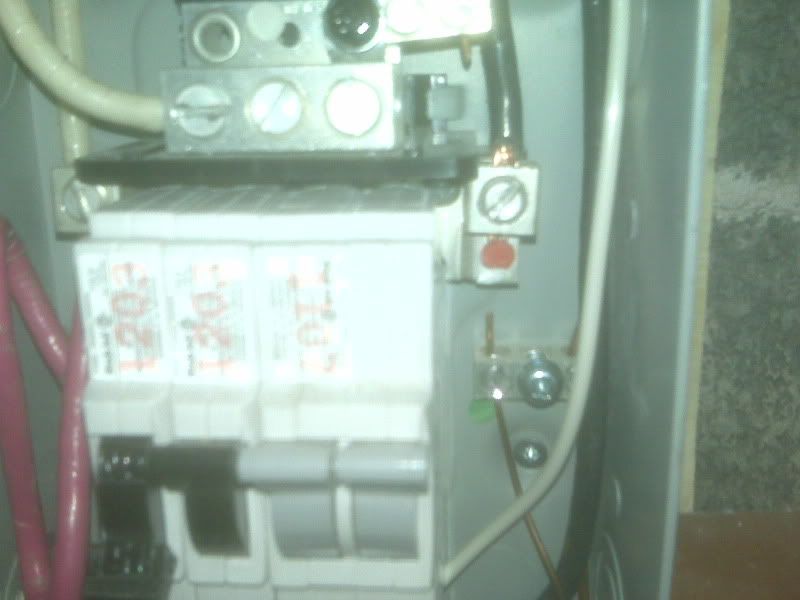

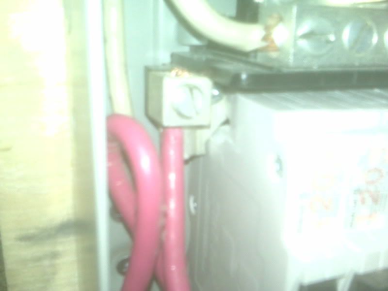

Is there a reason why the black and red wires are reversed? On the right the black wires hooked up to the lug with the red dot and on the left the red cable is hooked up to the black lug!!!

I've never seen a panel where the lugs are marked for black and red. It doesn't matter where they go, it's AC.

That one does It even has a green dot for the ground and a white one for the neutral!!! You can see the red dot right underneath the screw on the right side

Turn off the power in the service (main) panel and disconnect the wiring to the subpanel. Remove the subpanel and re-mount it with the proper orientation. Use the proper clamp to secure the incoming cable to the panel enclosure. Close off the now unused knockout holes with the proper seals. Re-connect the wiring. Re-energize.

Again, the locations of the hot wires do not matter. However, the neutral and grounds do matter.
