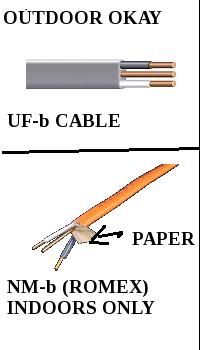

But here's the thing: You can't use "romex" - Type NM-b - to do that. Type NM-b cable is only approved for use indoors. You can use Type UF-b cable buried not less than 12" because it is GFCI protected. Or you can use conduit with individual conductors pulled through it. If you use the Type UF (Underground Feeded) cable, it will need to be protected by a conduit sleeve when it is not in the ground - from the GFCI breaker down to 12" below ground, and from 12" below ground up to the receptacle in the pumphouse.

WOW good advice and really FAST! How can I be sure he uses UF-b? Is it printed on the side of the cable jacketing? Is it better to have it in conduit for the whole run?

Yes, it will be on the jacket. If you see paper filler it is not UF cable. In UF cable the wires will look embed into it. Like the sheath was melted and poured around the wires.
