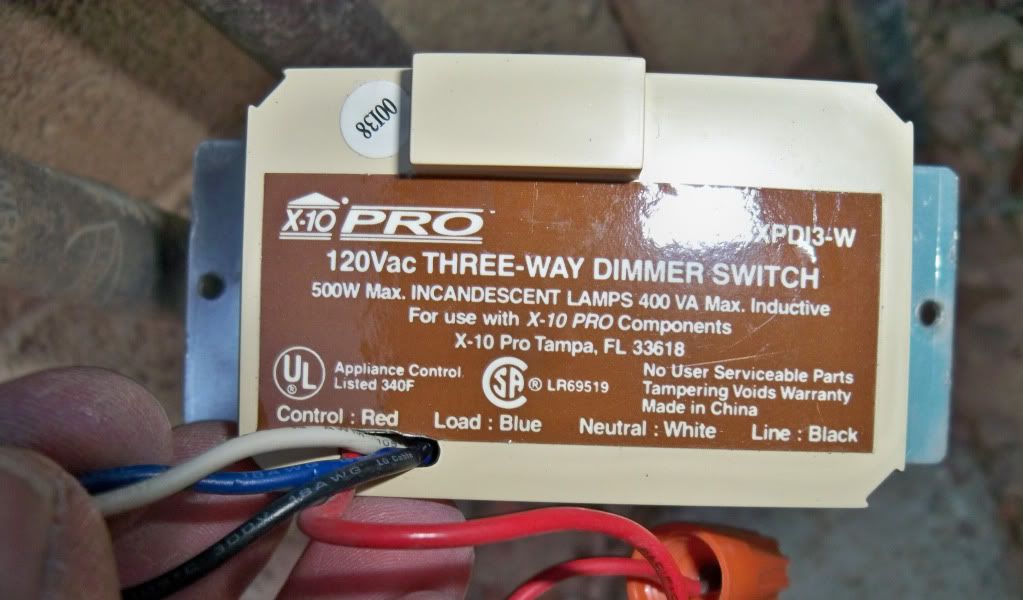

The x-10 switch has a neutral, load and line, here is a picture of that:
The Control line is not connected to anything - it worked with a wireless remote at one time and still works manually.
The new switch is a single pole 15/20A Heavy Duty switch. I will be connecting the line at the bottom, and the load at the top correct?
The neutral line will just go from the GFCI right to the light itself (which is basically what it does, only now it is goes to the x-10, then back to the light.)? I just want to confirm what I'll be doing.

It is the ground for a new double pole switch that has me wondering, if that X-10 is like the other, it won't have a ground....what do I do with that, just pick up a ground connection for the new double pole switch at the closest ground I can find? That GFCI is grounded in the pool light junction box shown above, I could just fish a ground over to that and piggy back on another connection - would that be good?
In general, it is verboten for any part of any box or enclosure to serve as any part of the EGC. That said, though, and looking at your picture of the inside of the J-box as it is wired now, it appears that this enclosure has been specifically constructed to allow its back plate to serve in that capacity. So, yes, I would say that you can
just run a ground wire from the switch to this junction box.
And I would use a listed ground screw to terminate it to that open boss in the upper right corner, rather that have multiple grounds under one of the other ground screws.
