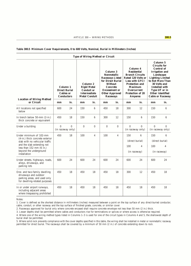

Hello all! New to the forum and I had a quick question. I ran 2 inch PVC pipe to the location for my soon to be build shed and plan on running #8 THWN to it. It is buried 18 inches deep. I picked 2 inch pvc because I also wanted to run cable and internet to the shed, but after reading a few post here, I am not sure I can run those in the same conduit as the wiring. So two parts:
1) can i run the cables in the same conduit
2) if not, can i run 1/2 conduit in the 2 inch pvc with the cable and internet in it?
Let me know! Thanks

No, no and no. First of all, the conduit should have been buried with a minimum of 24 inches of cover but depending on exactly where the conduit runs 18 inches MAY be acceptable to the inspector. I do hope that you used PVC electrical conduit and not PVC water piping, they are not the same.
Second no is that no, you may not mix communication cables with power conductors in the same conduit. That one is an absolute so the third no is that no, you may not run a 1/2 inch conduit inside the 2 inch for communications cabling.
Added advice, use nothing less than 1 inch conduit for communication wiring such as telephone, cable TV, Ethernet, intercom, stereo speakers and the like. You may go to a minimum of 3/4 inch if you absolutely know all you are going to have is a single coaxial cable, (TV) single Ethernet (Internet) and single telephone via category 3 cable.

The depth for non metallic conduit generally given in the forum is 18". The way I read table 300.5 of the 2008 NEC seems to support that.

I was going to say something about the allowable 18” for specific conduit. Outside of that, I agree with furd.

My fault for (a) going by codes several years removed from the present, and (b) most of the jobs I had any connection to being commercial rather than residential.
The last time I had any connection to an underground conduit job the inspector insisted upon 24 inch cover even though the only traffic in the area would have been foot and a riding lawnmower. This inspector questioned my use of IMC coming above ground (he said EMT was not allowable and I pointed out it was NOT EMT but IMC) but he passed the EMT the fence company used coming through the ground. I can't win!

I think you guys need to re-read Articles 300 and 800. My interpretation is that communications cable (and Ethernet, telephone, cable TV ARE communications) still require a minimum of 12 inches cover. Only landscape lighting and irrigation control is allowed a 6 inch cover AND that also requires a maximum of 30 volts.
I MAY be wrong. I only looked in the 2002 code and only skimmed the chapters.

There is no cover requirements for the OP’s installation, unless the OP’s jurisdiction says otherwise. Normally nothings required on the property owners side. T.300.5 does not apply—even if conduit is required. Personally, i would go 24" inches or deeper if DB. No less than 6", and anything up to 24" would be in conduit.
But, if you have a code reference, please post, as I’m no guru on LV.
