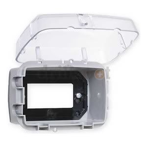

I wonder whether that receptacle had an in-use ("suitable for wet locations") cover before this happened, or whether you've installed one now.
As with the silicone caulk recommended by rich3236, I'm primarily posting this for future readers.

Yes the outlet had a cover. I had washed the siding in the past and not had a problem with it leaking enough to trip the GFCI. I will try the silicone caulk.

Nash asked:
and you answered:
But is it this type of cover?
