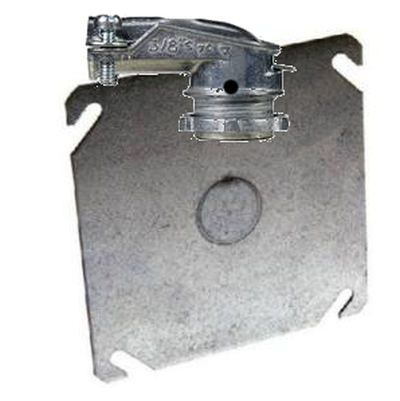

One final question I have is around the connection to the appliances. As always seems to be the case for me, what I have right now serves only as the example of what not to do, not as an instruction on the correct approach.
I discovered recently that the current line to oven was simply punched through the drywall and connected with wire nuts to the oven power cable. This strikes me as very dangerous because it means that the spliced wires were sitting directly on top of the metal shell of the oven. The line to the Cooktop was at least run in to a junction box, although this was rather haphazardly attached to part of the inside of the kitchen cabinet beneath the Cooktop.
Given that I have excellent access to all of the wiring, my current plan for both appliances in their new location is to run the feed wires in to recessed device boxes and then connect them to the appliance power leads within the junction box (both appliances are direct wire). The question I have on this are:
1. Does this sound like a good plan?
2. Is it OK to use the heavy duty blue plastic boxes, versus using metal ones?
3. What type of faceplate can I use for the junction box, given that the appliance power wire will be entering from the front, and not from the back as it usually the case with recessed boxes?
Old 07-30-12, 09:23 PM
Nashkat1's Avatar
Join Date: Mar 2012
Posts: 8,470
Received 1 Vote on 1 Post
Set a 1900 or a 4-11/16" box in the wall and use a flat cover with a center KO and a 90[SUP]o[/SUP] connector.
