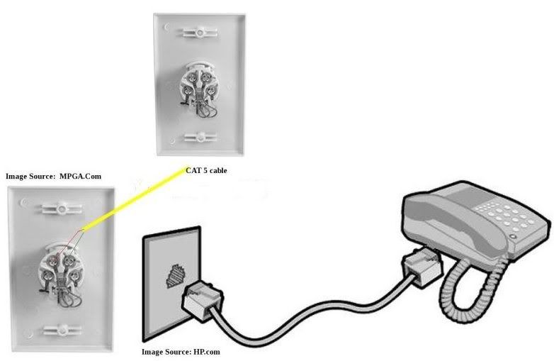

I want an RJ11 jack only if a matching plug will fit a round cat5.
Do you mean a male plug? If so you are misunderstanding how it is normally done. You install the female jack plate as earlier shown. Then you run a patch cord with two male plugs between the RJ11 and the phone you do not plug the Cat-5 into the phone which seems to be what you are trying to do. The Cat five is wired to the back of the RJ11 jack.

I think this is what I'm looking for. "Male/Male Twisted Pair RJ11 Cable." It's the twistedness that I want because it will be near 220 volts. I don't really care if it's not cat5. One end will be plugged in a telephone jack and the other will go through the wall and into a wall mount jack, so I'll cut the plug off of that end. The phone will have a regular flat RJ11 cable that's plugged into that jack. If I could get it in the U.S. I think that's what I'm looking for.
Old 08-17-12, 01:32 PM
ray2047's Avatar
Join Date: Mar 2006
Posts: 32,671
Yes and no. That is what you will use as a patch cord as shown below but you don't run it through the wall. that is done with the Cat 5 between the female jack plates. The Cat5 it is striped and fastened to the screws of each jack plate or surface jack.

OK, I'll use CAT5 cable with a RJ45 plug. I'll plug it into a surface mount RJ45 jack
No. You will strip it and wrap it around the screws. No plug is involved. You do not buy a cord with plugs. You buy a length of Cat3 or Cat5 cable. It does not have plugs nor does it need plugs. It simply is connected to the screws of the two jacks.
Please look at the picture in post 18 again.
