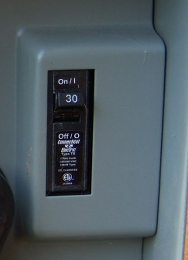

add regular 120V 15A (GF) receptacle to 30A RV service
I have an existing service for an RV or camper. It's 3 prong, 30A, has a breaker, and is in an outdoor enclosure. Please explain how to run 2 ground 120V 15A ground fault receptacles from that box. I am handy and competent, but I just don't know what wires go where. Please be detailed for me - I can follow a schematic if anyone has the means to draw one. Otherwise, just step by step text is OK.

You cannot have a general use receptacle protected greater than 20 amps.
Old 08-27-12, 11:11 AM
Join Date: Dec 2006
Posts: 28
Thanks - so it's the 30A breaker in the RV box that is the problem? It wouldn't protect the added 15A receptacles?
Old 08-27-12, 11:29 AM
ray2047's Avatar
Join Date: Mar 2006
Posts: 32,651
Yes.
Is the enclosure a breaker box? Can you add a breaker to it?
If your not sure post some pictures of it. http://www.doityourself.com/forum/li...-pictures.html

It's a specialized, dedicated RV power enclosure. Even the socket is unique to RVs. I was able to wire it myself, but I think I might be over my head at this point. I am covering the whole area with a shed and I will re-mount that enclosure inside the shed. I can either get a little breaker box and get help wiring it, or just spring for an electrician. But I should have known that the breaker protection wouldn't work with regular receptacles. Thanks for setting me straight!
My pic is too large to upload here, so I put it here instead http://i427.photobucket.com/albums/p...t/100_1963.jpg

If you installed a 120 volt only subpanel you could add a breaker for the 20 amp circuit.

from the panel cover it looks like there is room for a second breaker in this panel, remove the cover and see if there is busing to the second slot

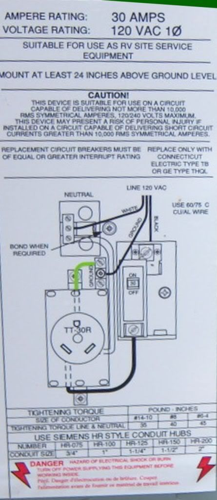

Breather, looking at the diagram I think you are right but I can't see a knock out in the cover

if there is busing for a breaker in the panel would it be acceptable to notch out the breaker slot?
it also could be scored on the backside

I did see a spot for another breaker! Sometimes I am as dumb as a box of rocks. I would have to find a Connecticut breaker and cut out the panel face to accept it. I have a picture here http://i427.photobucket.com/albums/p...t/100_1965.jpg

The name plate says it is also listed for GE breakers
Old 09-02-12, 10:21 AM
ray2047's Avatar
Join Date: Mar 2006
Posts: 32,651
Here's the label. GE breakers are easy to find.

Maybe it just me but the wire feeding this panel looks smaller ( 12)than the wire going from the neutral bar to the outlet which looks like 10. Please check this.

The wires going into the box are definitely 10 ga. The insulation thickness is different, so the wires look like different sizes.

For you great helpers who are still following my progress; I got a GE 20A GF breaker (thanks braether3 and ray2047 - because Connecticut breakers seem to be scarce here) , and I cut out the faceplate to accept it. I mounted a weatherproof box on top of the RV power enclosure with a duplex receptacle inside. But now I have to wait to 1) move a shed, 2) build a retaining wall, 3) bring in fill dirt and gravel, and 4) have the metal carport installed. It's hard and expensive having fun in an RV!
