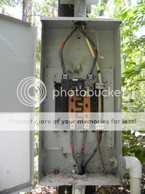

I can't get an electrician out and need to install a 30 amp plug before the Labor Day weekend.
I have a multi meter, so I know to check for voltages AFTER I turn the main breaker off at the service pole and then the secondary main breaker off at the area I want to wire. I'm pretty comfortable doing the job, just need a little guidance after that.
Here are a couple of pics. The sides of the breaker say Murray, iirc.

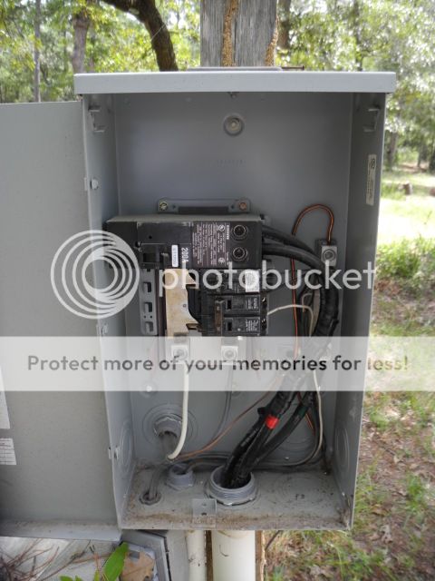

I'll cut the main power off here:
Need to add the outlet on the post this secondary box is mounted on.

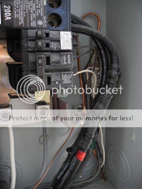

Side view into secondary box:

It looks like you have an open slot for a single-pole 30A breaker below the breakers that are in the second panel now. Do you have some additional questions?

You have room in the main but not the sub. Which box did you want to run it from?

At the same time you should fix your code violations. The second panel is a subpanel fed from the first panel if I understand this correctly and you appear to be grounding the neutral conductor in the subpanel. In addition, both panels appear to have feed-thru lugs. The 200 amp protected lugs in the subpanel have what appears to be #6 conductors in them. What are those #6 wires feeding and is it a big deal if they burn in two? Also, what's up with the water pipe at the lower right of the main panel? One last thing, when using phasing tape to mark conductors, you use white for neutral and not green.

We need the service at the sub. I think whomever did the work ran out of conduit and used white pvc. Unfortunately, all the work was done before we purchased the property a few months ago.

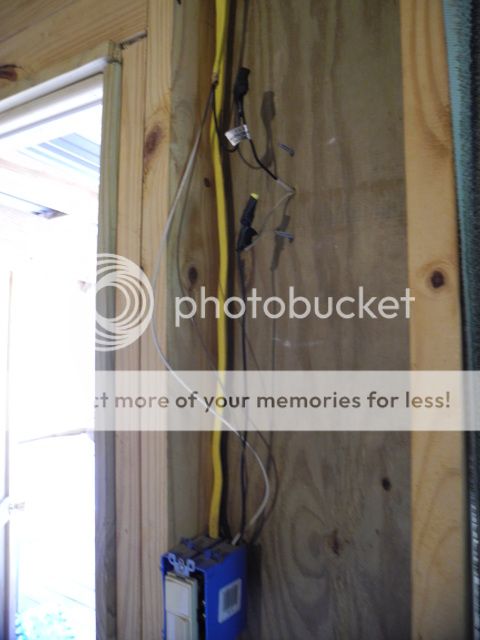

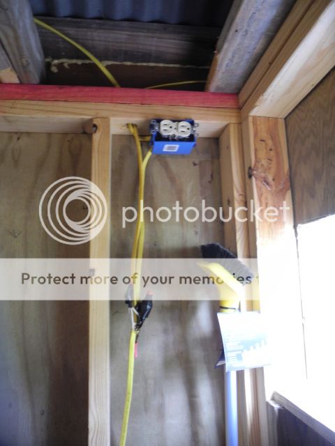

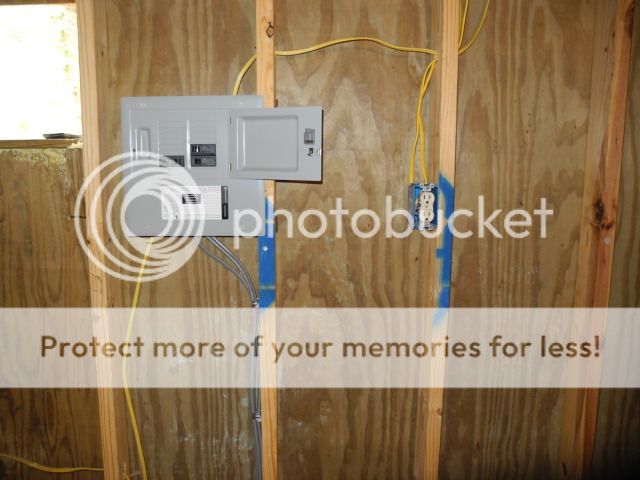

For chuckles, here's some of the work in the cabin. Hoping to get everything sorted out and corrected once we go over the septic bids.

We can help you fix that if you have questions.
All splices need to be in accessible junction boxes. The cables also need to be secured.
