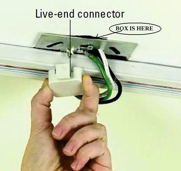

ImageShack® - Online Photo and Video Hosting
The wiring of the track looks like that. I then used electrical wiring (the one that has 3 solid wires wrapped within insulation, the ground being bare as you mentioned before) to wire the wiring from the tracklight to the wires in the electrical receptacle.
Now, that piece I showed you in the image before, I was thinking about wiring the two together from each tracklight and then running that straight to the receptacle as I did when I had a single tracklight.
I just wanted to double check that it would be okay. I'm studying engineering currently so I have pretty good understanding of this stuff but as I'm still learning, I like to ask questions so I know for sure. Knowing the theory is one thing, application is a whole other thing sometimes.

If you notice in the picture you linked to there is a box in the ceiling that the live end connector connections are made in. Did you wire it with out a box? If there is a box run a 12-2* or 14-2** NM-b cable from that box to the new box.
*12-2 if 20 amp or **14-2 if 15 amp breaker.
Old 08-28-12, 01:06 AM
M
Join Date: Aug 2012
Posts: 7
Yea there was no existing box in my ceiling
Would have made this a MUCH easier install however it wasn't the case. That is why I , as I mentioned in another post, ran those wires with a 12/2 straight to the outlet receptacle's wires that are controlled by the dimmer.
One should have been added. Without it your existing connection may not be code compliant unless the cover is specifically rated for connections and it probably isn't.
It really sounds like the first install was done incorrectly with the wrong wiring method, improperly removing the code required receptacle instead of leaving in in place and hot, and not installing the required ceiling box. It might be best to start from scratch and rewire the first light correctly then the new light. We will be glad to help you with that.

My suggestion was based on the belief that the live ends on your track lights have terminals for connecting house wiring and an opening for mounting a cable connector to feed the cable through. Many such fixtures are made this way.
If that is not the case, then mounting a ceiling box directly above where you want the live end to be, as Ray suggests, should be the code-compliant way to do it.
The installation instruction instructions should have made this clear. If you followed those, you should be OK.
