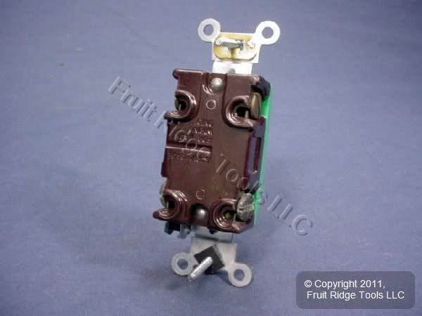

i looked at one of the outlets and all 4 wires are backstab wires only one coper wire is screwed
should i just check them all and see if they are lose
i think there is around 10 and 3 switches :\

i looked at one of the outlets and all 4 wires are backstab wires only one coper wire is screwed should i just check them all and see if they are lose
Best to just move them to the screws. That is the only way to know if they were the problem. Black to brass, white to silver. A bare wire is a ground and it goes to the green screw.
Here is a picture of backstabbs:

i looked at one of the outlets and all 4 wires are backstab wires only one coper wire is screwed - should i just check them all and see if they are lose
No, you should make sure the power is off, remove the wires from the backstabs, separate them, turn the power on, and test, using an analog meter, to see if there is 120V between either black-white pair.
Regardless of whether you found power or not, you should splice the whites together with an added pigtail cut from white-insulated wire, protect that splice with a wire nut, and terminate the white pigtail to the neutral side of the receptacle, curling the wire, clockwise around one of the two silver-colored screws. Tighten both silver-colored screws. You should then do the same with the black wires, using black-insulated wire and one of the brass- colored screws.
Mount the receptacle. If you found 120V when you tested each pair of wires, turn the breaker on and see if you have fixed everything. If you didn't find 120V when you tested the pairs of wires for the receptacle you just re-worked, leave the breaker off and move one outlet in the direction you think most likely to be toward the home run from the panel, and open it, remove the wires, and start the process again.
If you found power in the box for the receptacle you just re-worked, but your work didn't fix everything, move to the next receptacle or switch that is away from the panel.

You can also just move the four wires to the screws. In someways pigtails are better but not necessary. The important thing is not to use back stab connections.
