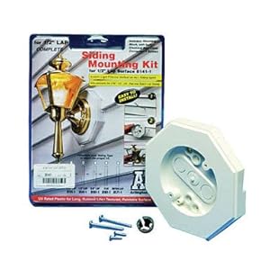

Agree. Take that box off the house and see what's behind it. If there's a recessed box behind it, just attach the mounting plate to that. If there's no box, you'll have to install a proper one. You can also get one of these with a flat back, they are listed as a junction box.
